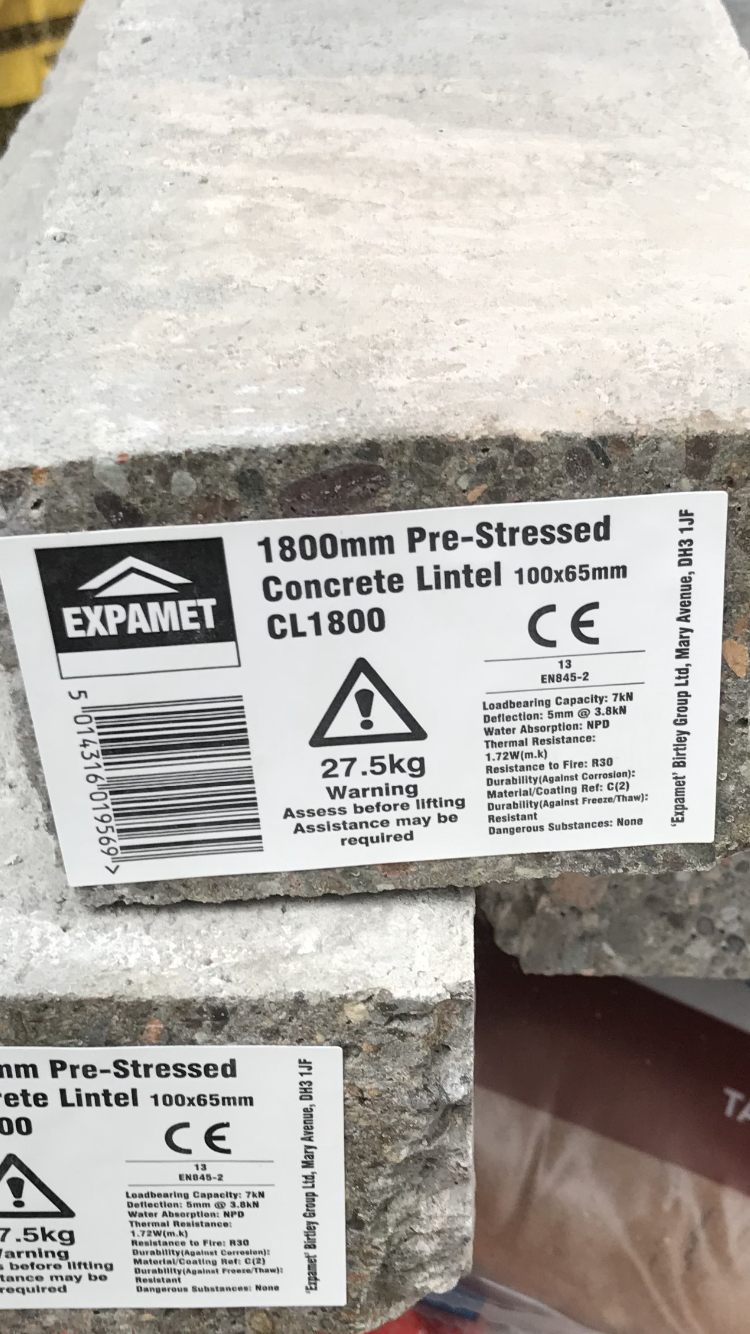

It might have a ticket on it like this:
But I doubt the BCO will want to see it.
