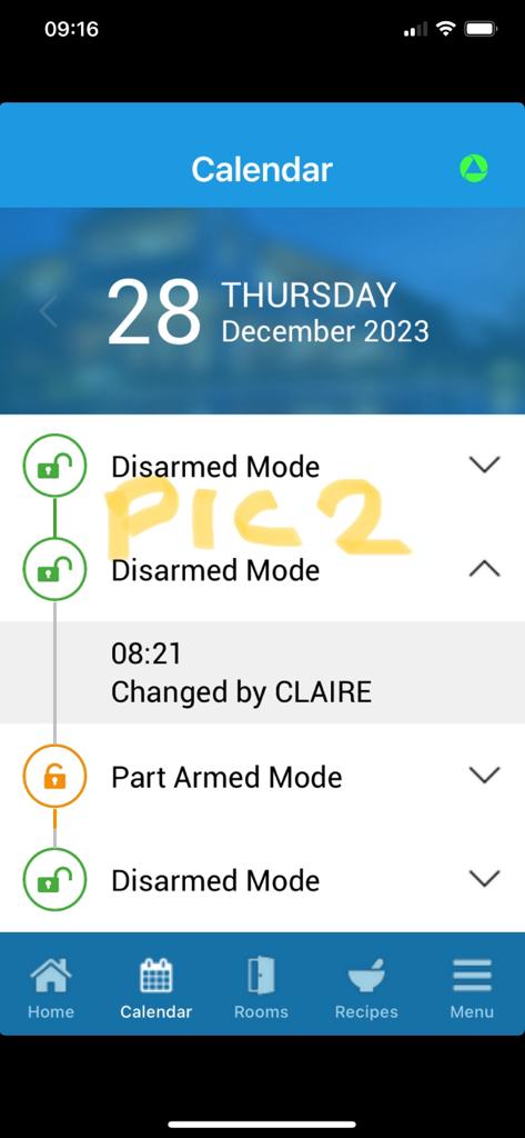

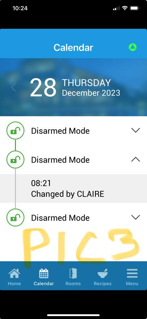

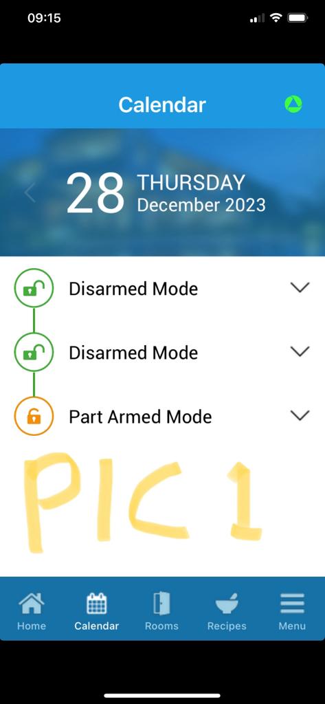

If the alarm is set/armed from the RKP the live status in the app shows it as part or full alarmed as it should, but it only records in the calendar when it has been disarmed,(as Pic 2) and it only ever records disarmed actions. I would like the calendar to show history of all arms and disarms

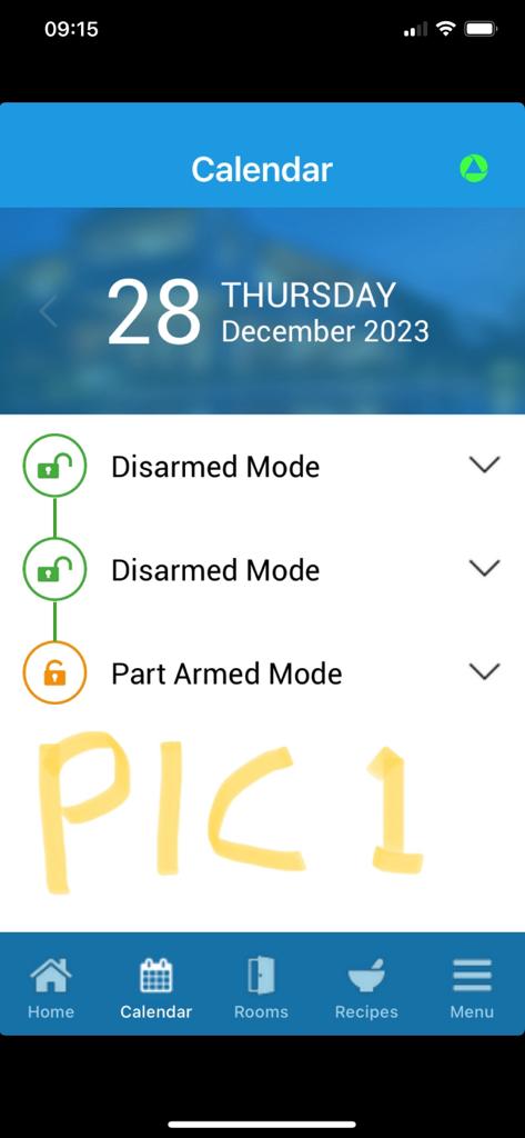

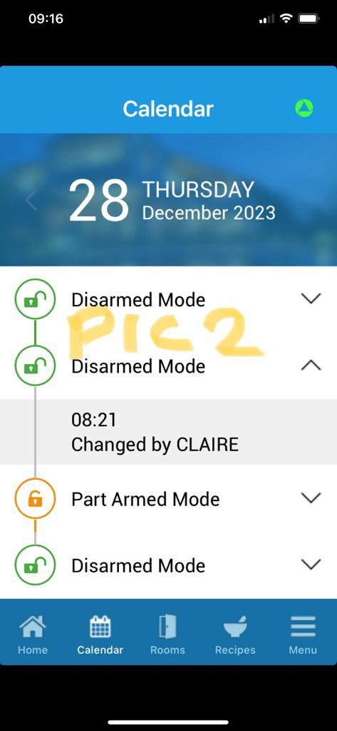

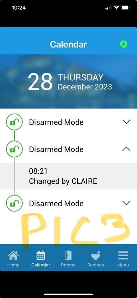

Oddly, I noticed that when I set a part alarm from the App it did show in Calendar (pic 1 and 2) but it soon disappeared and changed to disarmed after disarm have been executed. (pic 3)

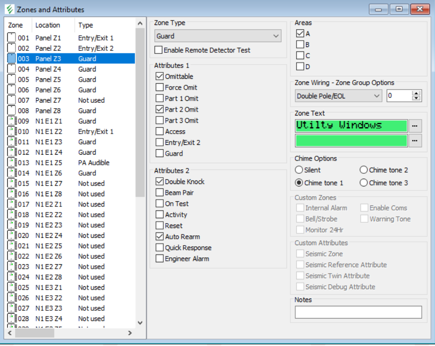

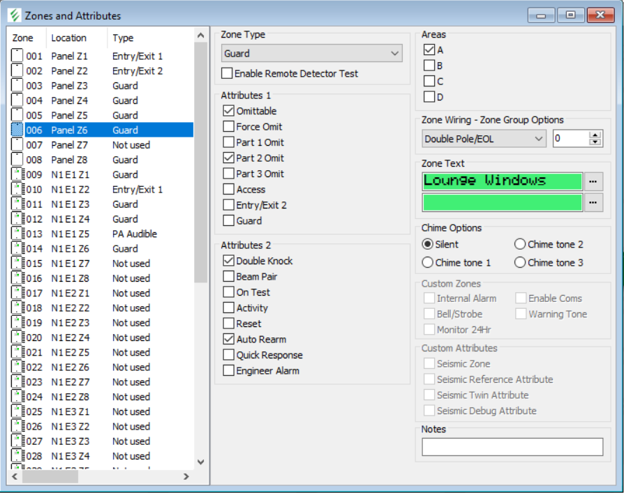

re your reply above - I did set part arm coms in area options but that sent a push notification and beep to my phone for each and every PIR that it excluded (both on exit and entry) which was a bit annoying, I simply want it to record it in the calendar with a single notification and history record - is that possible?

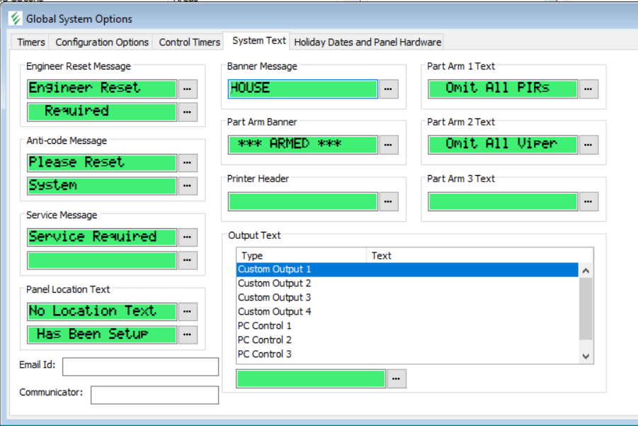

If I understand your question correctly, no; each device is named differently i.e utility windows and Lounge Windows
No global text ….eg where you put in reset message, printer text, part set 1 , 2 , 3 names

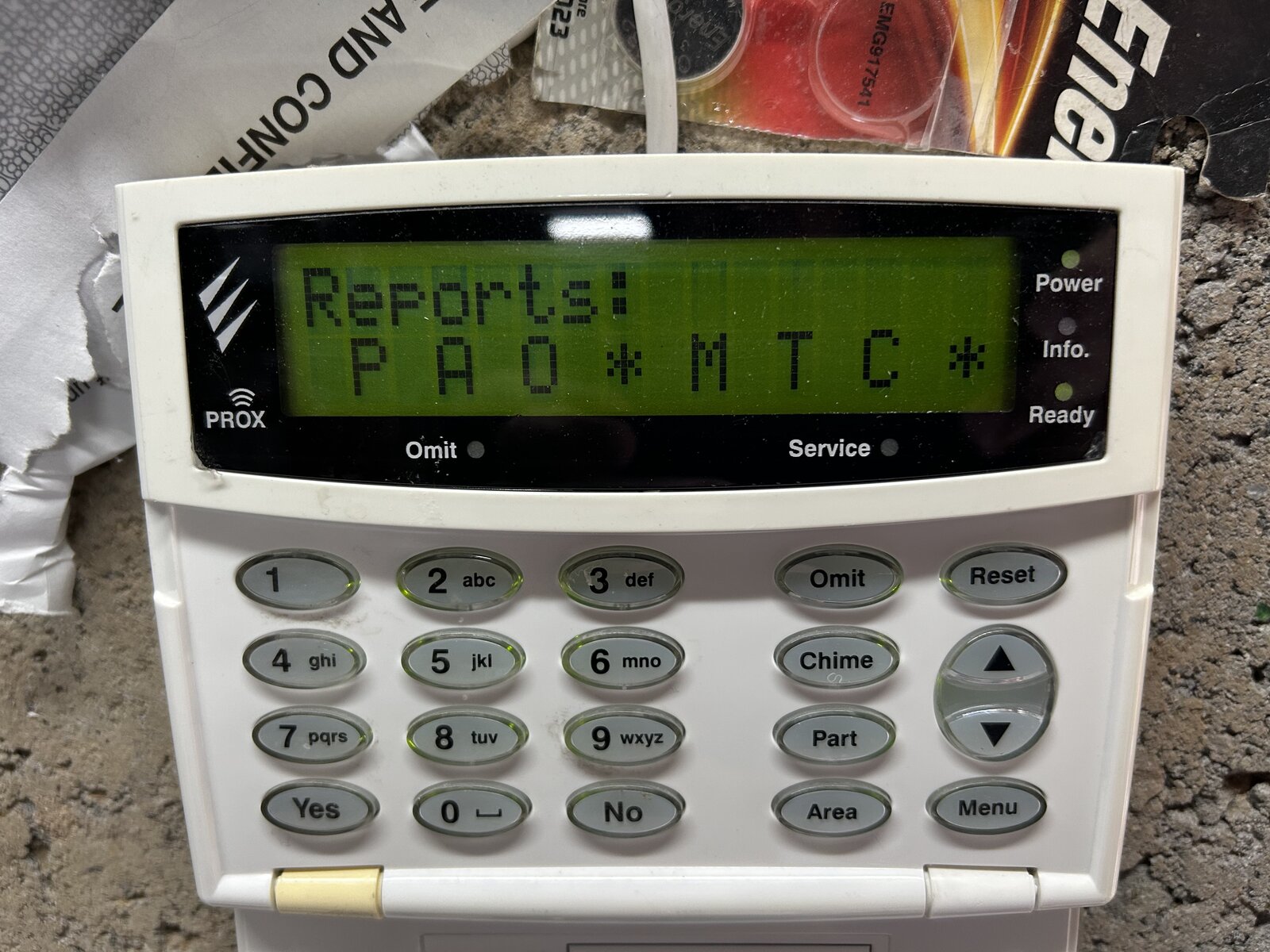

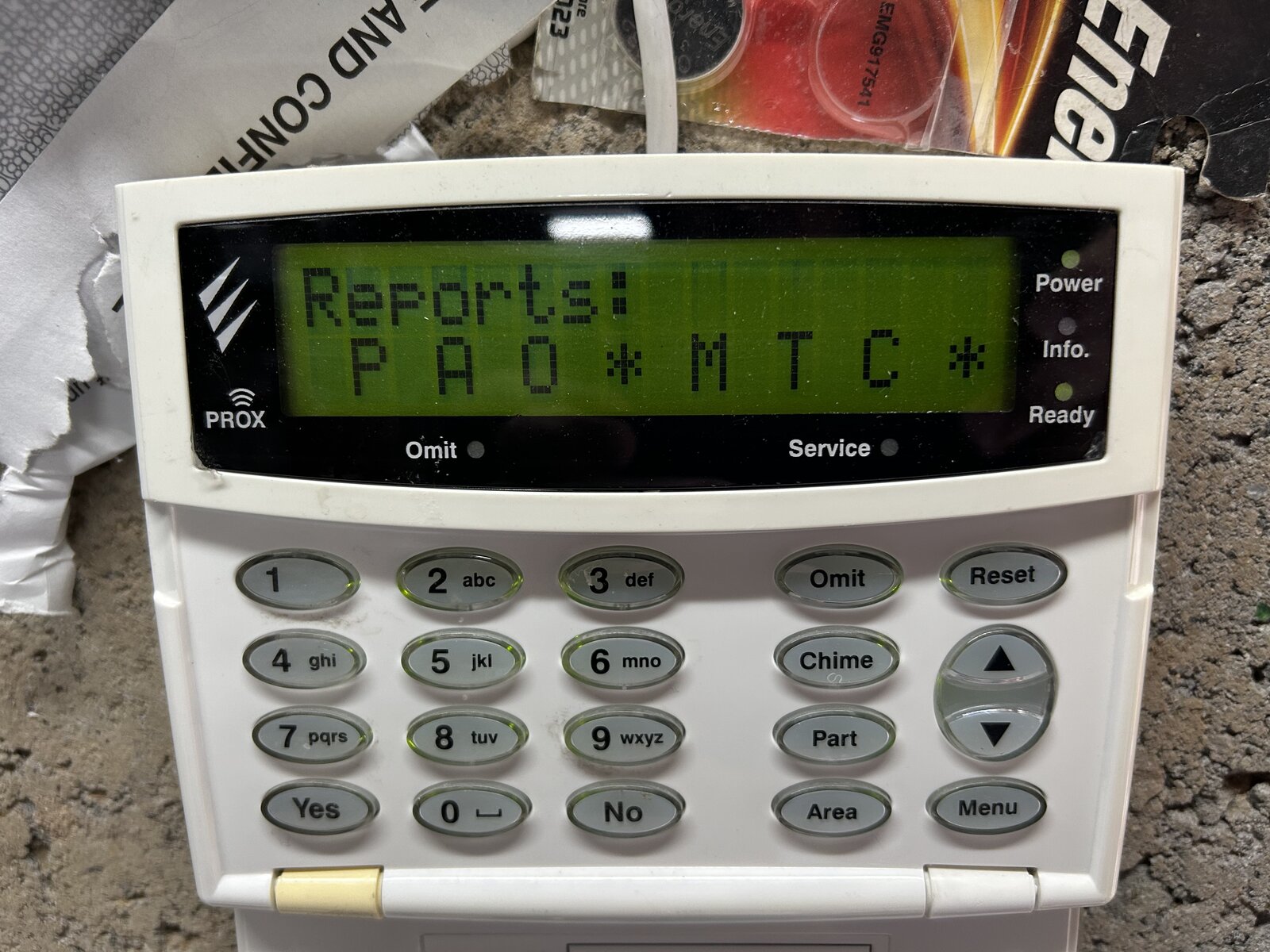

Think you need to turn back on comms in part , then turn off the omit attribute in comms / UDL settings in reports
If you wish you can send us yourr full profile and i can take a quick look to see if i can see anything.
You have my details i believe.
Thank you very much for your help, I get a bit twitchy making changes through the RKP so I will take SecureIAm's offer, good to hear from you again - Have a good year.
