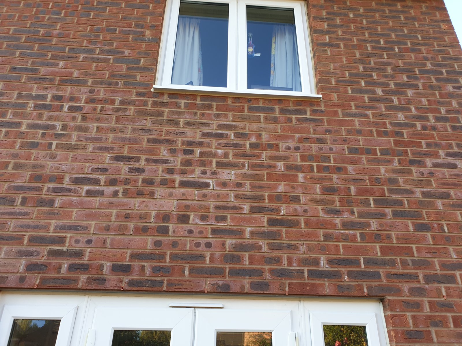

I posted a couple of years ago about some mortar cracks that we have. I've attached an up to date picture where you can see the step crack between the door and the window.
I want to get this fixed, so is it just a repoint or something else? Which trade should I engage?
Thanks!
Has the actual cause of the crack been identified and dealt with?
So I guess that's the next question. There are no corresponding cracks inside, I have looked in the upstairs bedroom and the plasterboard is fine.
It's a seven year old new build, and the cracks have been there for at least four years though it's hard to see if they are getting better or worse.
I had just assumed settlement, but I guess I could be wrong?
Cracks similar to the ones in your pics can be caused by lintels failing thus leading to the stepped cracks in courses either side.
Although I can't see that being the cause with a lintel of that age (providing it's been fitted correctly) . It's movement of some sort you'll have to find out where.

Thanks for all the replies so far. I've spoken to NHBC as the house is only seven years old so hopefully they will be able to help out.
I got up the ladder and measured, the cracks are 2mm wide, so a bit more than hairline!

Whilst I wait for NHBC, I was wondering if there was any obvious reason for this type of crack. I've read that subsidence/ heave tend to be wider at one end whereas these are widest in the middle of the diagonal, and hairline at the ends. Fully appreciate it may not be possible to analyse on the internet!

Summary of investigation was "...consistent with minor settlement of the lintel..." There was no evidence that it is related to foundation movement.
The solution is to either repoint now or later. As we are looking at selling the advise was to leave for now for the reasons @KenGMac mentioned- repointing can make it look like you are trying to hide something
Or you keep a copy of the investigation should a future buyer/surveyor query it. My front bay window wall needed repointing so it was repointed -- I wouldn't just leave it.
