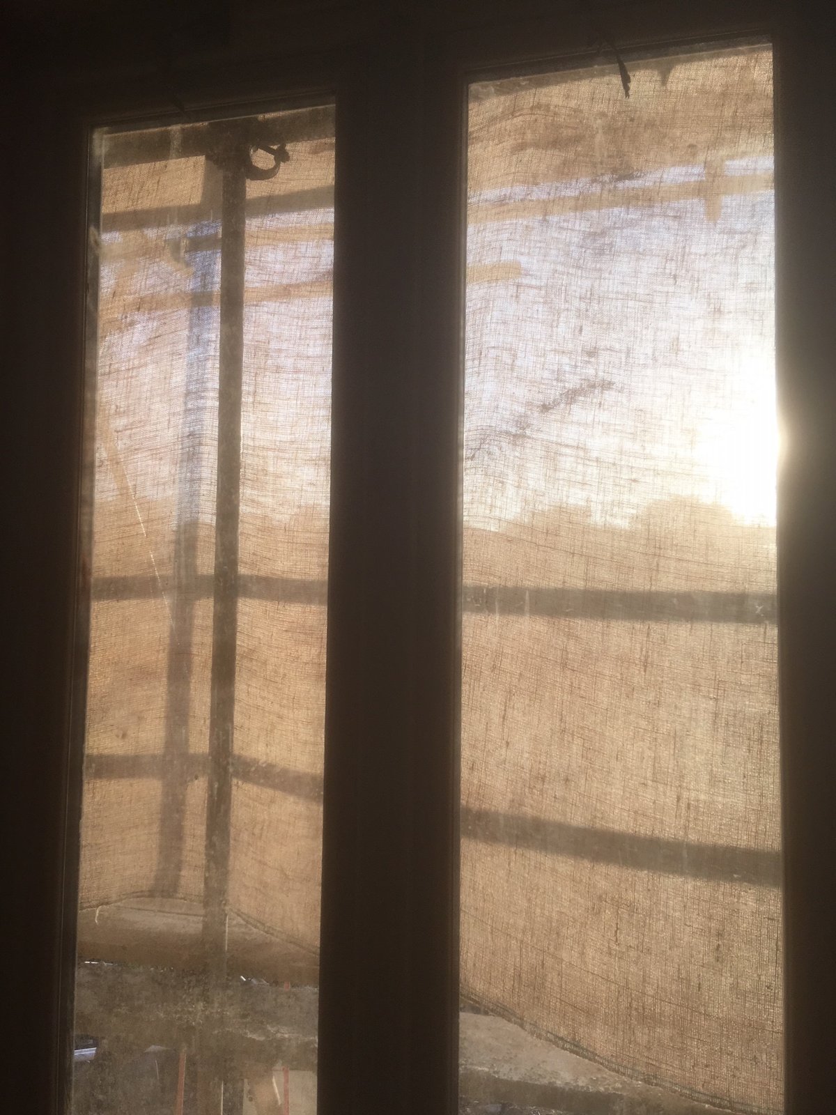

I order some big pvc windows which were meant to look out into the garden. The chap said they would have a thin astragal bar going down the centre which I agreed to. However, these were installed yesterday and they look awful! The bar is very wide and ruins the view!
I dont have the money to take the windows out and put new windows in.
Is there any way the bar can be reduced or removed completely? I know this will mean new glazing, but I want to check if this is even possible.

Ive just looked again and its a Mullion bar. Is this a non-starter? Ill post a photo later.
Here are the windows:
Can anything be done with the above bar ripping them out and starting again?

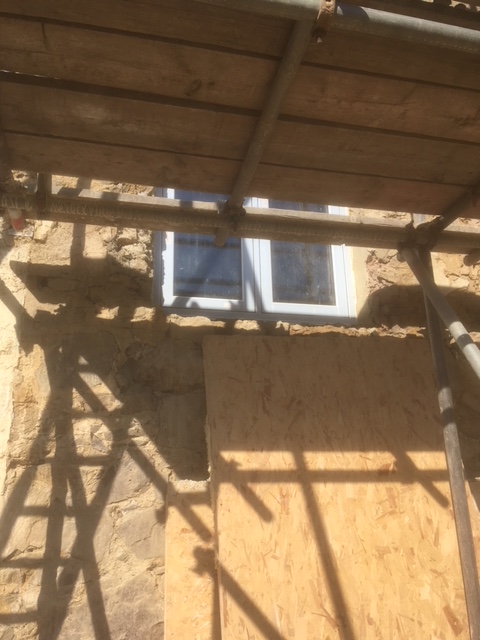

And heres a smaller window. Theres just so much plastic!!:
Only option would be new differently designed windows.
The section thickness's are pretty similar what ever make you use. There are some thin framed aluminum windows around but personally I would say the price tag is not worth the extra cost unless you have tiny windows (2-3 times the price of PVC).

Can you get a better photo of the tall one? Too dark and too close.
We are assuming they are doors by the look of it but really cant tell from your photos.

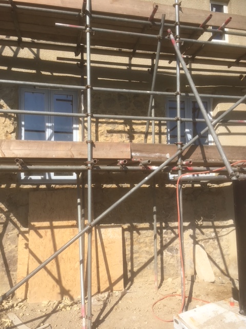

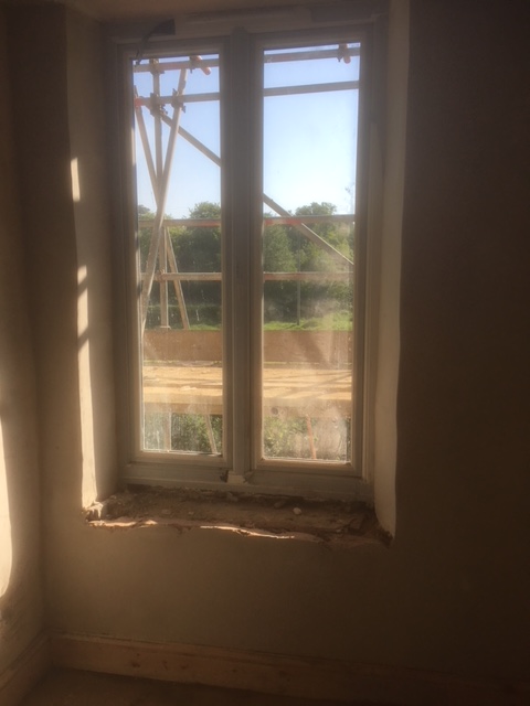

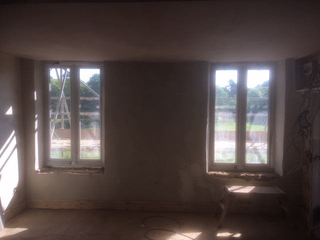

Here are some more photos (external and internal). As you can see, theyre almost the size of patio doors. What they were MEANT to be were big windows with a thin lie down the centre. There looks to be more plastic down the middle that in your photo of actual patio doors!!
This is certainly NOT what I was expecting, the installer knew what we were trying to achieve. What do you think? What recourse do I have?
BTW, these were taken on a very sunny morning, they are a lot darker normally.

If you want tall narrow windows with 2 sashes, you will always have a big amount of frame and sash stile in the centre.
Your options are; change the windows to a single fixed light. Or maybe change them to a French door window with no centre mullion, so when the sashes are open there is no middle bar.

In timber, the centre section would be about 160mm wide with a central mullion.
With rebated French door style sashes and no mullion, width would be about 130mm
Edge of plaster to glass would be about 85mm.
Aluminium would be the only slimmer option.
Whatever you chose, the centre part can nver be a slim bar, that cant be achieved with a window with 2 sashes. You will always have 2 x stiles and the mullion.
I think the window configuration is wrong. They should either have been wider, or a fan light at top over a single direct glazed light below.
Or just a single pane fixed and a window elsewhere for ventilation.
Ok so they are defiantly windows and not doors. Also looks to be flush sash windows.
I cant see any handles or handle holes on them, Do they not open at all?
