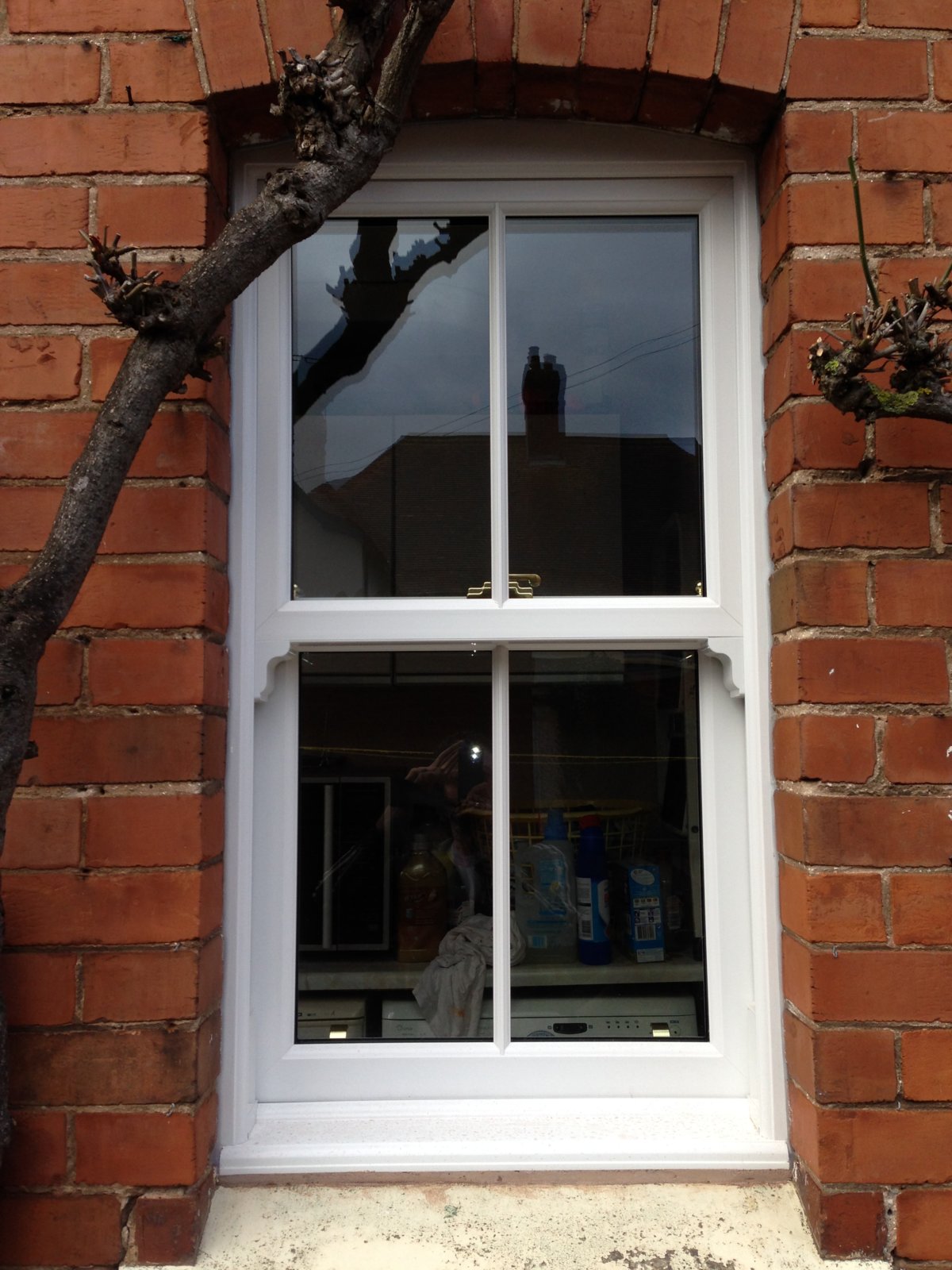

Now does your contract state Astragal bars down the center of these windows? Because those are not Astragal bars.
(see my photo for a vertical sliding window with an Astragal bar down the center which is approx 20mm thick).
What you have is a mullion and 2 dummy sash's side by side.
If your contract states Astragal bar you may have some comeback here. If it does I think either he has filled out the ordering sheet wrong or his suppliers have made it wrong and hes just gone ahead and fitted them anyway hoping to get away with it.
Possibly worth posting a scan of the wording in the quote/contract with your details edited out.

Well they have supplied as per the drawing it would seem to me.
It seems odd they are both dummy sashes...did you not want openers?

It would seem your installer, if he did the sale, didnt communicate very well with you what he was intending to supply. Or at least he didnt interprete your requirements very well into what he thought could be made. To be fair, a window frame of that width would usually be split into 2 with a central mullion.
A cheap solution would be to take out the fixed sashes and direct glaze into the frame. The centre mullion would then only be about 60mm wide. Overall you could gain about 160mm more glass width for the window and about 80mm on the height. Thats assuming the profile allows direct glazing - most do, but Ive never dealt with flush casements.
You could salvage this by removing both dummy sashes along with the mullion which isn't welded into the frame and direct glazing into the outer frame, this would of course mean you need 4 new beads cutting and the windows would be externally beaded but at 1m off the ground might not be too much of a problem
