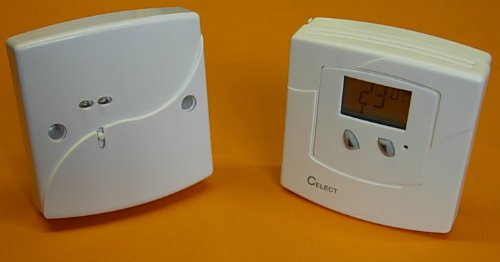

Can wireless stats be wired up ?
I want to use the prog room stat with the screen, bot the transmiter box.

On the left is the receiver which is wired and switches the boiler (or whatever).
On the right is the sender unit - programmer/thermostat/transmitter which can be placed anywhere.
On the left is the receiver which is wired and switches the boiler (or whatever). ... On the right is the sender unit - programmer/thermostat/transmitter which can be placed anywhere.

I want to use the stat transmitter and NOT the receiver.
Thanks for info, hope everyone understands what i wnated to do, but will just buy a wired stat.
Thanks for clarifying. As you will realise, that is how I (if not others!) have interpreted your question all along - and, as I (and EFLI) have said, you just can't do that. Apart from anything else, the transmitter has no terminals to attach wiring to, nor the internal switching facility which it would have to have - it merely sends messages to the receiver, which is where the wiring connects and the switching occurs.
