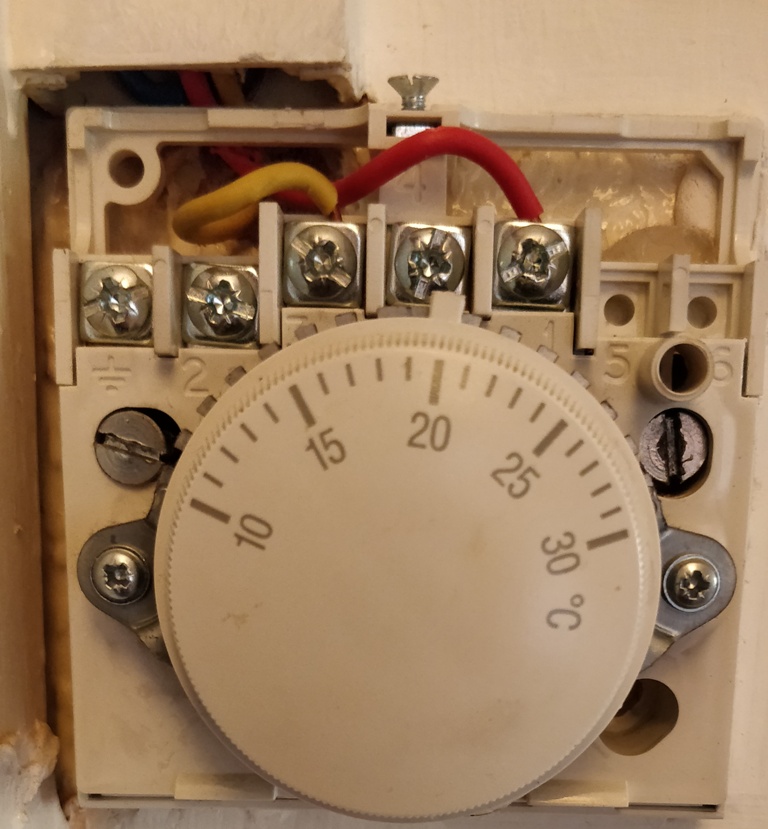

2017-11-06 15.00.24 boiler thermostat.jpg this is my old one.. two wires, yellow and red.

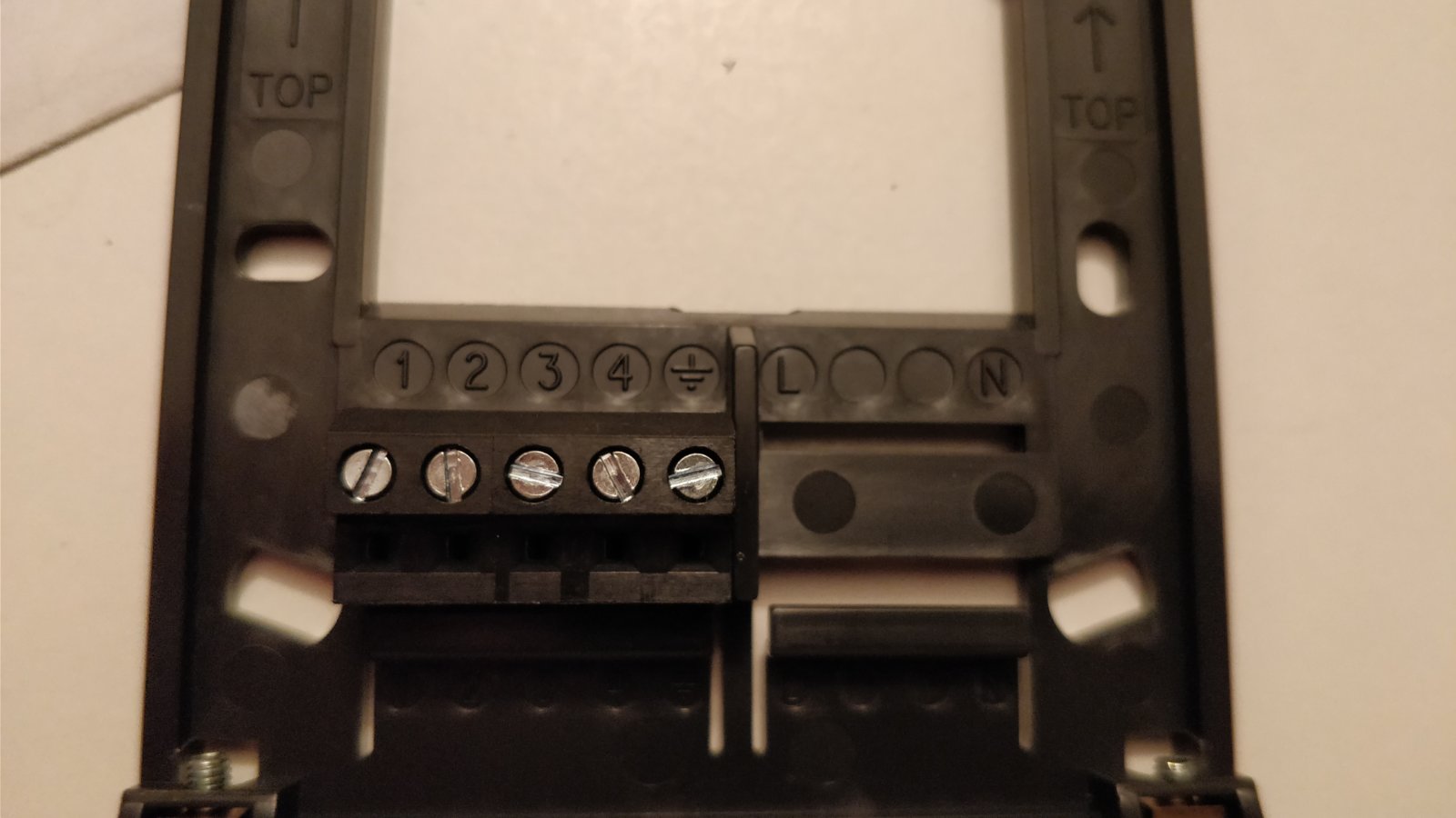

IMG_20171121_205603.jpg this is my new one. with holes numbered, 1, 2, 3, 4, and earth

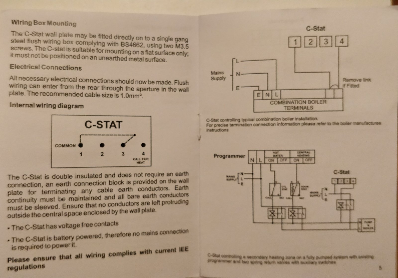

IMG_20171121_205554_01.jpg and this is some of the manual.
http://horstmann.securemeters.com/f...ller_guide_c-stat_11-B-17-B-Installation1.pdf

Red wire goes to Horstmann thermostat terminal 1
Yellow wire to Horstmann thermostat terminal 4
There may be blue wire hidden away at the back of the existing thermostat which may be connected to a neutral. You don't need it, but insulate it and tuck it out of the way if there is one.
Also, whilst the Horstmann is double insulated and doesn't need an earth connection, if there is an earth wire present, park it in the terminal provided to keep it out of harms way.

Would you mind explaining how, from the schematics you know red goes to 1, and yellow goes to 4? I'm just curious.
Thanks :)
I don't mind at all. It tells you in the manual you posted the link to.
A thermostat is just a switch. When heat is required, the two wires are connected together inside it.
The supply usually goes to the 'common' and as the red wire currently is the live supply to your existing thermostat, goes to 'common'. The yellow wire goes to the other side of the contact that is energised when the C-Stat 'Calls for Heat'.
