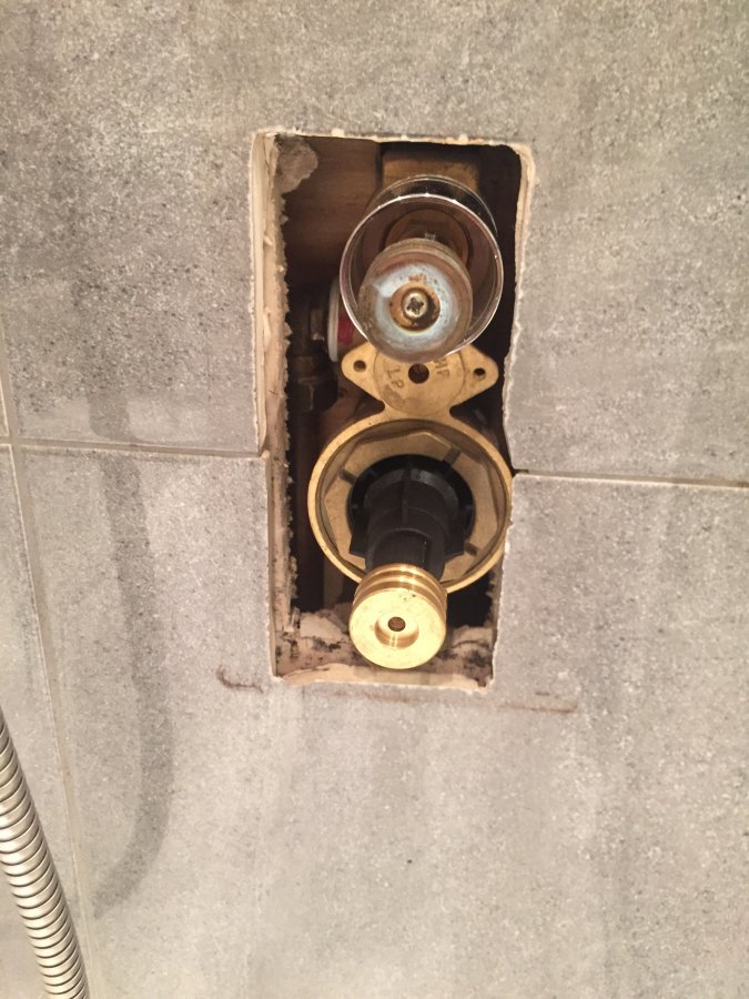

Hi, I have a deva shower, not sure what model but there is a pressure issue. The cold pressure is fine however as the temperature is turned warmer the pressure goes down to next to nothing. Boiler fine and bathroom taps fine anyone know what the issue is or how to remove the cartridge? I have got this far:
