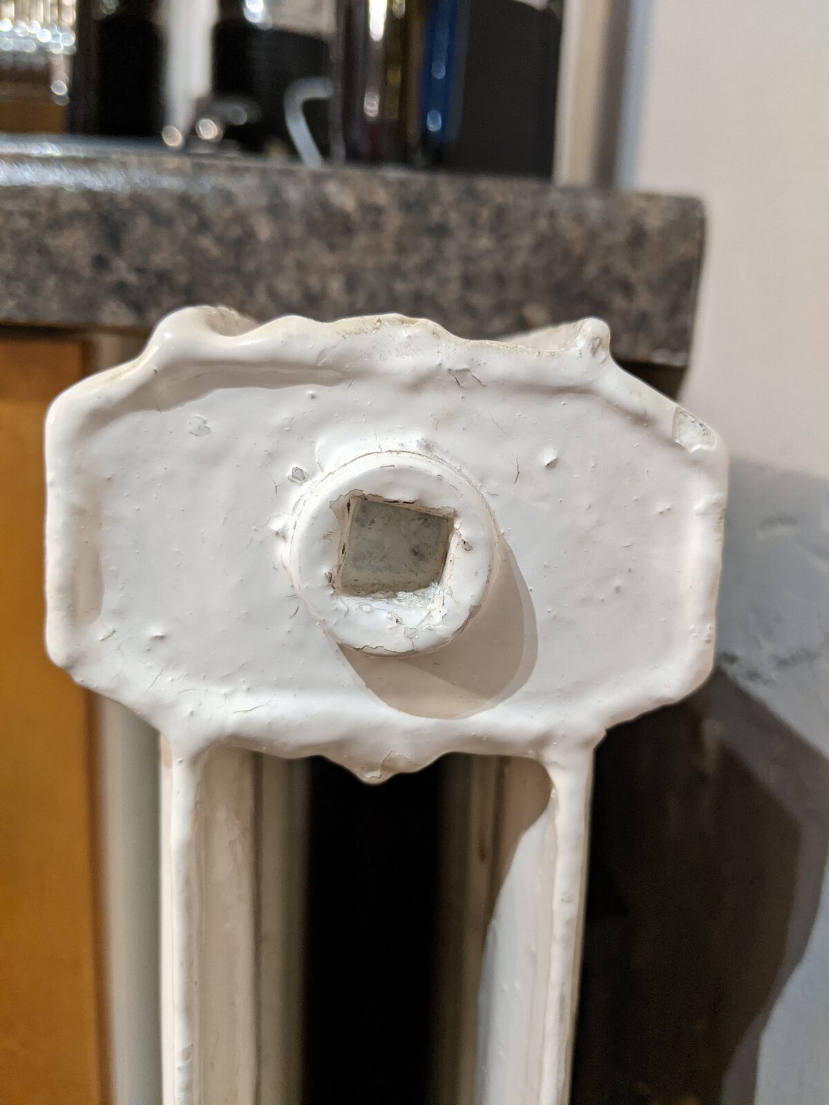

Hi I have a radiator under a piece of my kitchen worktop . I can't bleed it because the bleed screw is on the end I can't get at . Is it possible to make this end into a bleed screw ? I'll post a picture
Can't see why not. Best of luck unscrewing that end though.
I've found in the past a 1/2" square drive from a socket set ratchet taps into the square....you may get lucky!
John :)
Doesnt matter which end you put the bleed point on you can have one on each end if you want, good luck getting one to fit that though, and you will need to buy a rad key to fit one if you can find it, just change the rad and send that one to a museum
