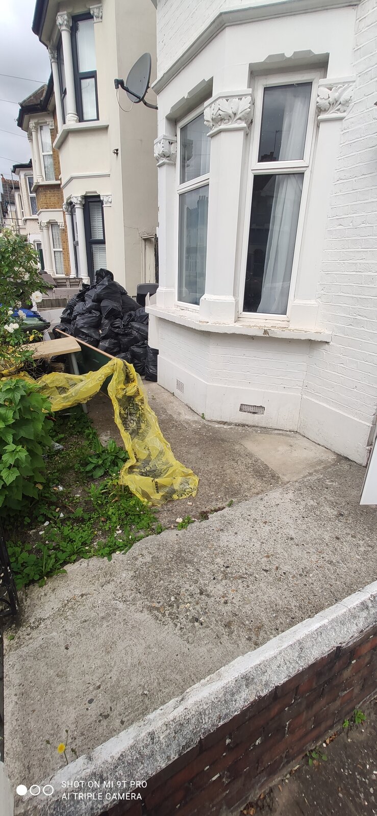

Hi all as per the title. Looking to put down some porcelain tiles in the front garden, the builder who can said the existing concrete doesn't need to be removed and they can place directly on top.
Is this correct?
I always thought the concrete needs to be removed and hardcore putdown,
Yes, porcelain can laid on top of concrete with outdoor tile adhesive no problem
