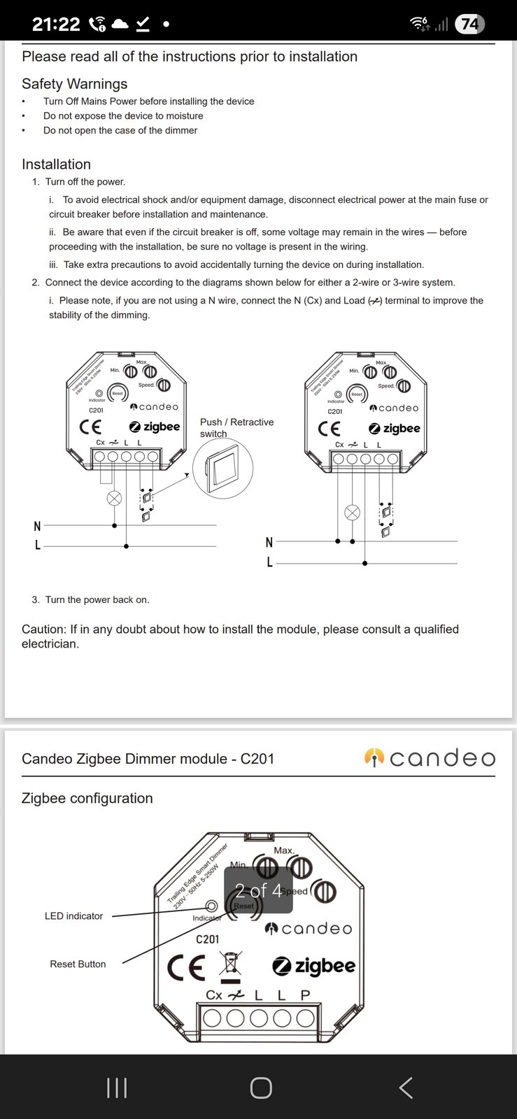

Hi,
Id really appreciate a bit guidance on how to wire this dimmer module. I have 1mm TE coming in from the lighting circuit and then another 1mm TE running to my LED lights.
Could anyone advise on which live and neutral goes where?
Thanks in advance

Never used one but it iooks like both neutrals into Cx
Live out to ~
Live in to L
And the switch between the next L and the blank terminal.
Use the righthand diagram.
Connect both neutral wires to the leftmost “Cx” terminal.
Connect the outgoing to the lights live to the second “~” terminal.
Connect the incoming live to the middle “L” terminal.
