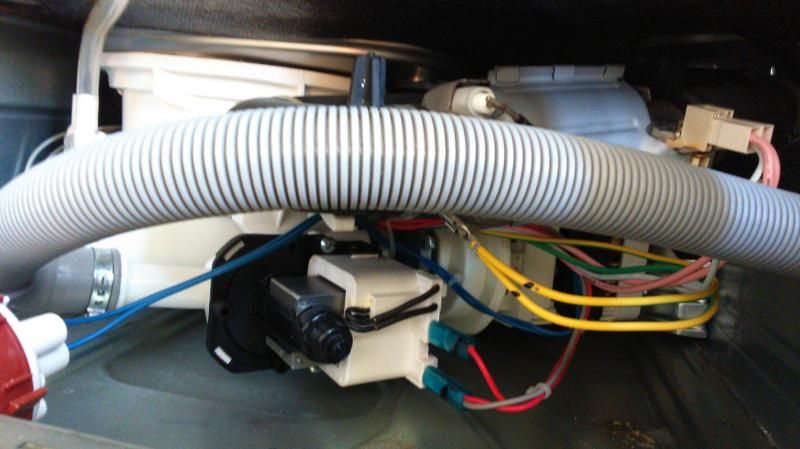

I guessed the drain pump would be near the filter and the drain hose, so I took off the right side panel. There are a number of screws on the top and sides of the panel, and it slots into the bottom. The drain pump is the black square thing with the white square sitting on it, just left of centre in this pic:
You can see that it feeds directly to the left into the grey waste hose. The big white thing behind it is the bottom of the filter which you can see/remove to clean from the inside of the dishwasher.

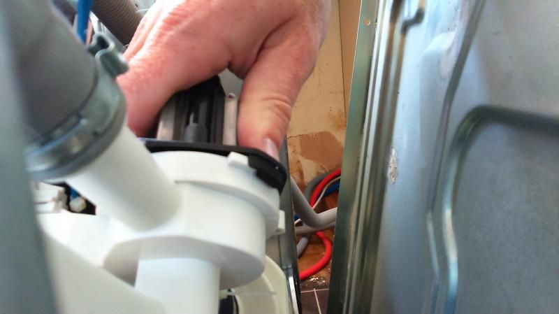

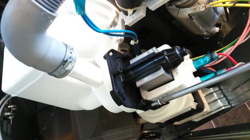

Anyway, once I got these screws out:

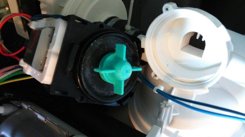

...the pump twisted off from the housing:
The problem noise was caused by a bit of broken glass, about the size of my thumb nail, trapped in the white housing, so that it would get hit by the green impellor blades as they spun:

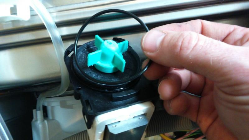

Once that was removed, I cleaned up the dirt and limescale deposits from the mating surfaces, because I didn't want it to leak. Don't forget this rubber ring:

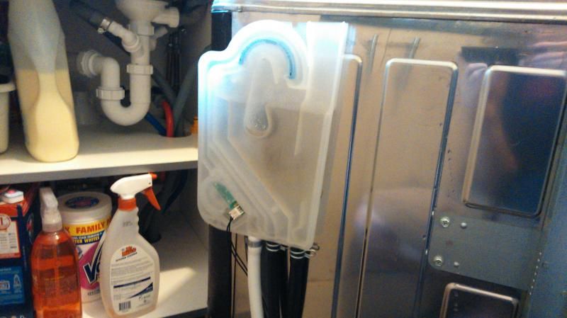

I knew it didn't have this fault before I took it apart, so I disconnected everything again and took the right side panel off again to check I hadn't pulled a wire or something. Nope, all looked as it should. Then I took the left side panel off, so I could see where the inlet hose went into the machine. That's when I saw this thing:
I don't know exactly what it does, but it's half full of water and has an opening at the top... which had spilled water all down the side of itself when I laid the dishwasher on its side! At the bottom of this device you can see a connector with two little black wires. Behind the bit of green circuit board you can see is a little plastic water wheel, sitting in a clear plastic pipe which can be traced directly to the inlet hose. My guess is that the little wheel turns when water flows, so that a sensor can "count" how much water has entered the machine. If this arrangement was faulty, the machine would be filling up with water, but it wouldn't know it and would think that no water was coming in.
I unplugged the little connector, and sure enough, it was soaking wet! Traditionally, electricity and water don't like each other. So I got a hairdryer and patiently dried out both ends of the connector, and as much of the circuit board bit as I could get to.
Plugged it all back in (didn't bother to put the sides back on until I'd tested it this time, but was very careful not to touch anything) and - success! It all appears to work as it should and the dishwasher has just completed a full program as I write this!
