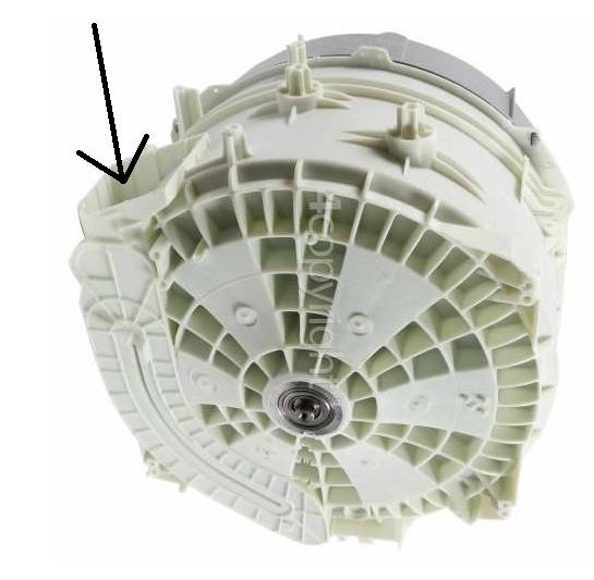

Candy Washer dryer, model number GVW 496T-80
The dyrer stopped working recently. After pressing the thermal reset button on top of the inside of the machine, it would work. It would then stop working again as it would overheat once more.
I removed the metal "exhaust" on top the machine that connects into the drum, that has the fan motor on top. There was lint everywhere on the inside, blocking airflow and causing it to overheat. I removed as much of this as i could, however the "exhaust" continues down the back of the machine, on a plastic part that is built onto the drum. A repair engineer has advised it will be blcoked further down, and you cannot get to it, or remove this as it sbuitl onto the drum
So my question is, can i pour sink unblocker/vinegar and bicarb down there to try and dissolve the fluff thats lodged further down there than i can reach?
Do you have a vacuum cleaner with a flexible hose that you could push down it or attach it to a piece of hose of a suitable diameter if the vac hose will not go down.
Unfortunately the gap that goes down is really small, probably only 20mm wide at best. Also the further down you go, the wetter it all is. As it drains away into the bottom of the drum, it's wet and claggy
I'm not familiar with this type of machine but just trying to help. So if you can't suck it out can you turn the machine upside down or tilt it far enough to drag the sludge out with a straightened wire coat hanger or similar. Is the repairer suggesting you need a new drum?

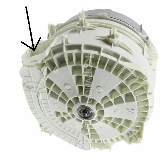

Its not a bad shout. I did put a coat hanger down there was far as i could and pulled as much out as i could. I think it goes right down under, much further than i can reach, into the drum. He did say if me clearing it as much as i can doesn;t clear or fix the issue, it'd be a new drum, as its a single unit! Really bad design in my eyes. Its 7 years old or so, so is had a godo amoutn of use, with 2 kids and a dog. We're waiting until we can do the kitchen up, and will integrate a new one, so need this to just go for a bit longer if i can. I've attached a pictire of the back of the drum, so you can see how i mean. The arrow shows where the air/fluff goes and you can see where it goes down. There'sa bend and its really narrow, which again is poor design. This is what made me think about pouring somethign in there to dossilve it, but im worried whatever i put down there may cause damage in other parts of the machine, or it dislodges ratehr than dissolves it, and it then all gets stuck in the pump/filter and causes that to break instead
You can flush it down with a garden hose, it's a two man job with someone turning the tap on slowly to start with in case it backs up.
Put the machine on a rinse afterwards empty, then check the filter for any lint.
