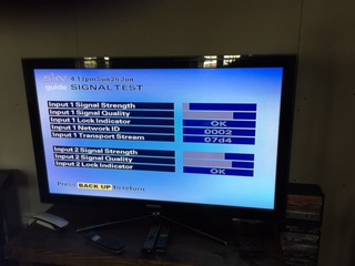

No matter how I adjust the dish the signal strength on ''input 1'' does not move while the other three indicators [qual 1 and 2 and signal 2] all move according to movement of dish.?
What happens when you swap over the F connector cables on the back of the box?
Swapped over and remains the same , so box problem?
The picture from both channels seems fine though no loss of picture or sound.
