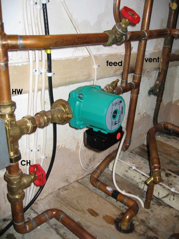

This is my system (although pump has been replaced):
The motorised valve works fine - hot in either/or HW and CH pipes as selected. HW is no problem at all. There is a 15mm return from the HW tank tee'd downstream into the 22mm radiator return. Hence my assumption that it is the return (up to this tee) and not the flow that is the problem. As you can see from the picture, there is not much room for a blockage to occur. Am I making any sense?
Can't make out what those gate valves are doing, especially the one on the CH flow. Why is it there, and is it fully open? What's the one above the pump? Not enough of the pipework is visible from your pic.
One above pump will be for balancing hw
One on ch flow will probably be so you can completely isolate the 3 port valve for maintenance without draining (presuming the tee on the hot water flow pipe on the top left goes to an air vent?)
Gate valve above pump goes to HW cylinder. Return from cylinder on right of picture with drain plug. Pipe above 3 port valve has a bleed screw. All valves fully open.

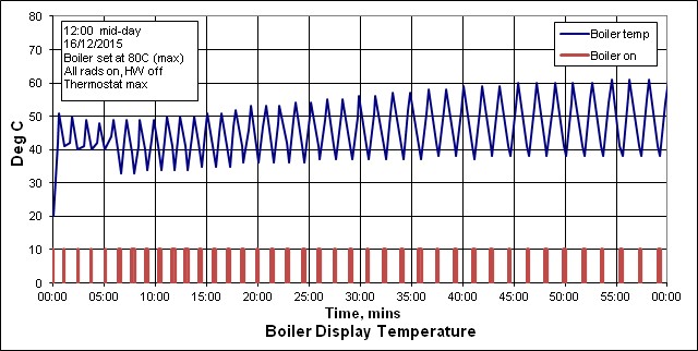

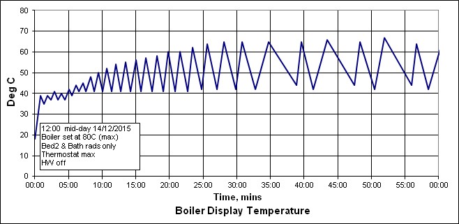

The following boiler temperature plots show what is happening.
The first is with only the two nearest rads upstairs, so no effects from ground floor drops. I have only recorded the boiler on/off temperatures and joined them with straight lines:
The second is with all rads on. I have added the boiler on/off periods (on for only 25% of the time). After 5 minutes, I also recorded the lowest temperature reached a few seconds after the boiler fired up:
