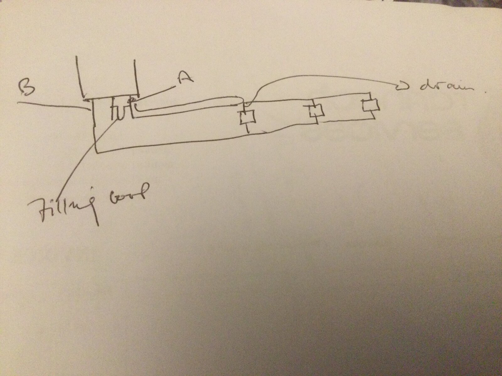

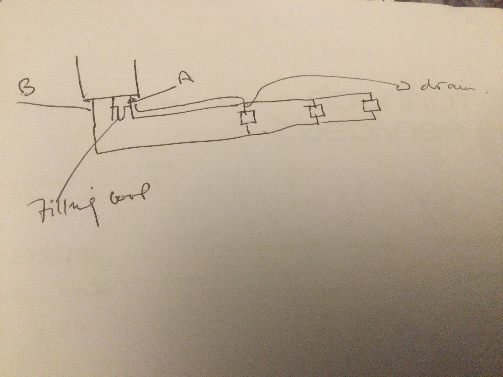

Best to sit down and sketch what you imagine what the pipe layout is. You will then realise why the muck left in the system is not clearing
Water through valve A will only clear pipe to drain point
Water through B not A will clear the radiator but only the base rib of the radiator
Running the boiler at say low temperature, and having drain point at appropriate location, will clear the radiator totally but will need trickle flush for much longer time
