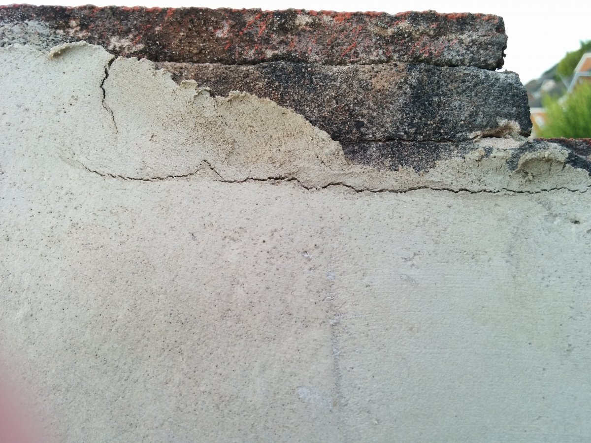

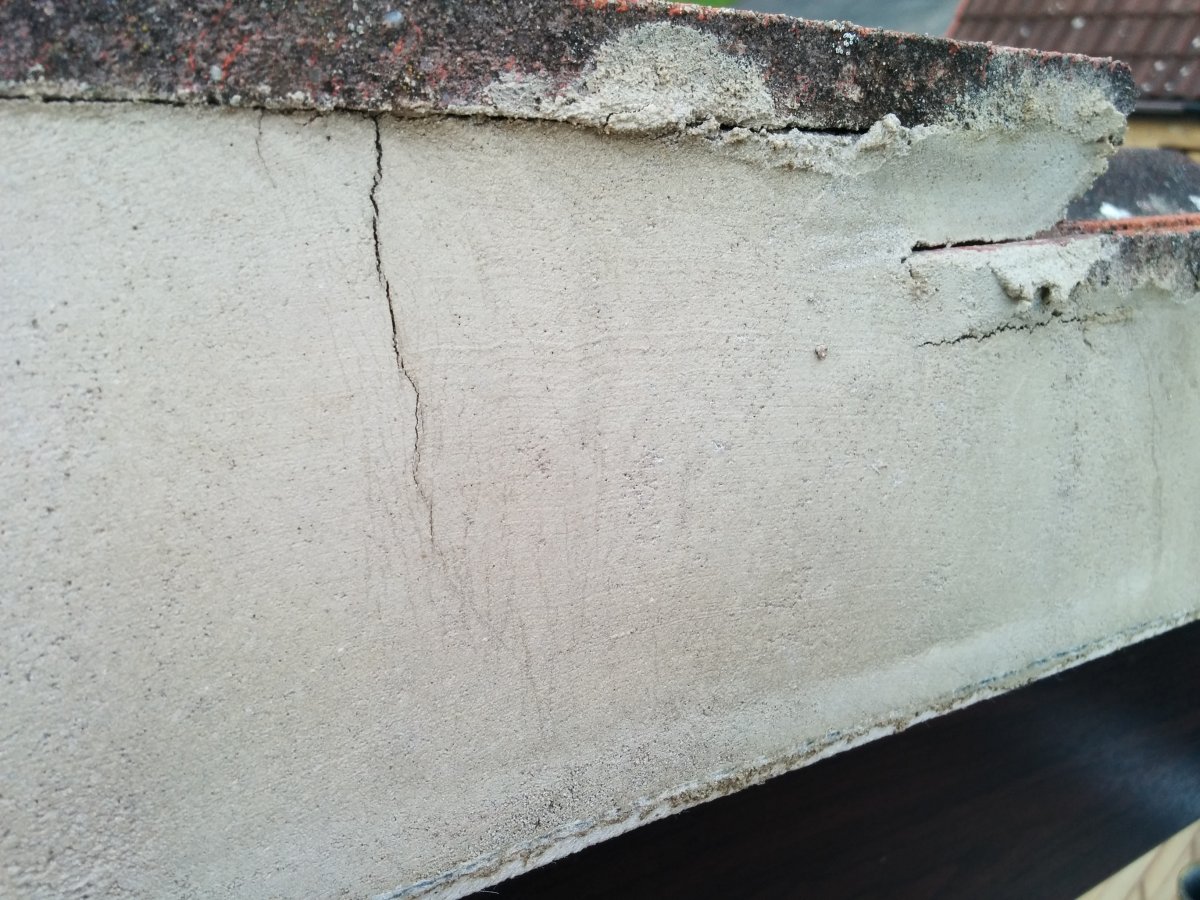

Whilst the scaffolding is still up I decided to climb up to have a look at the repointing work on the gables. I found that there are already a few (every half a metre?) hairline cracks on the mortar (see photos). Is this normal? It was done yesterday and it rained shortly after they've done with the repointing. Could this be the cause of the cracks?

Verges should not be repointed, as it will just fall off after a few winters.
Cracking is normally due to building sand being used instead of a blend of building and sharp sand.
Thanks woody
All of the old mortars were taken out beforehand though. I guess that's not good enough?
Repointing is leaving the existing mortar in place and going over the top of it. If all the mortar was removed and replaced with new, then that's OK.
The cracks are shrinkage which is not ideal, but it's common

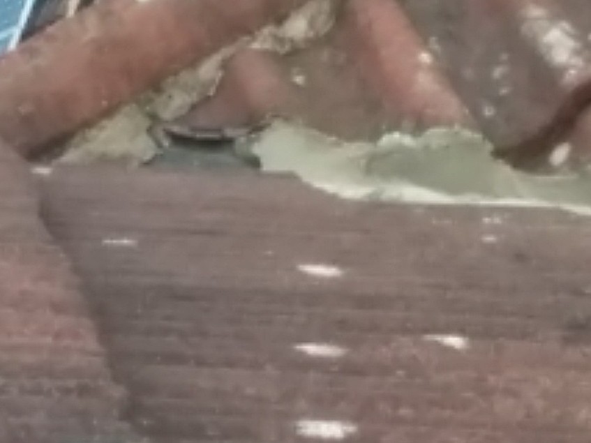

Went up and had a look this morning and found that they have missed a section at the top of the valley! From the photo you can see a fairly large gap without mortar.
