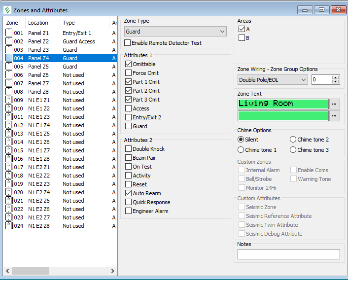

Hi have an elite 24 panel and i tried to set up an extra part arm setting but in the keypad settings it only shows the part arm 1 & 3 no no.2 part arm. so i changed the text to night for 1, 2 for 2 and 3 for 3 and updated the panel, the app reports these as correct but trying to set up 2 back in the keypad and it doesn't show part arm 2. wintex shows part arm 1,2 and 3 ticked for my zones that i want to omit for example 2021-04-13 (2).png, any help ?

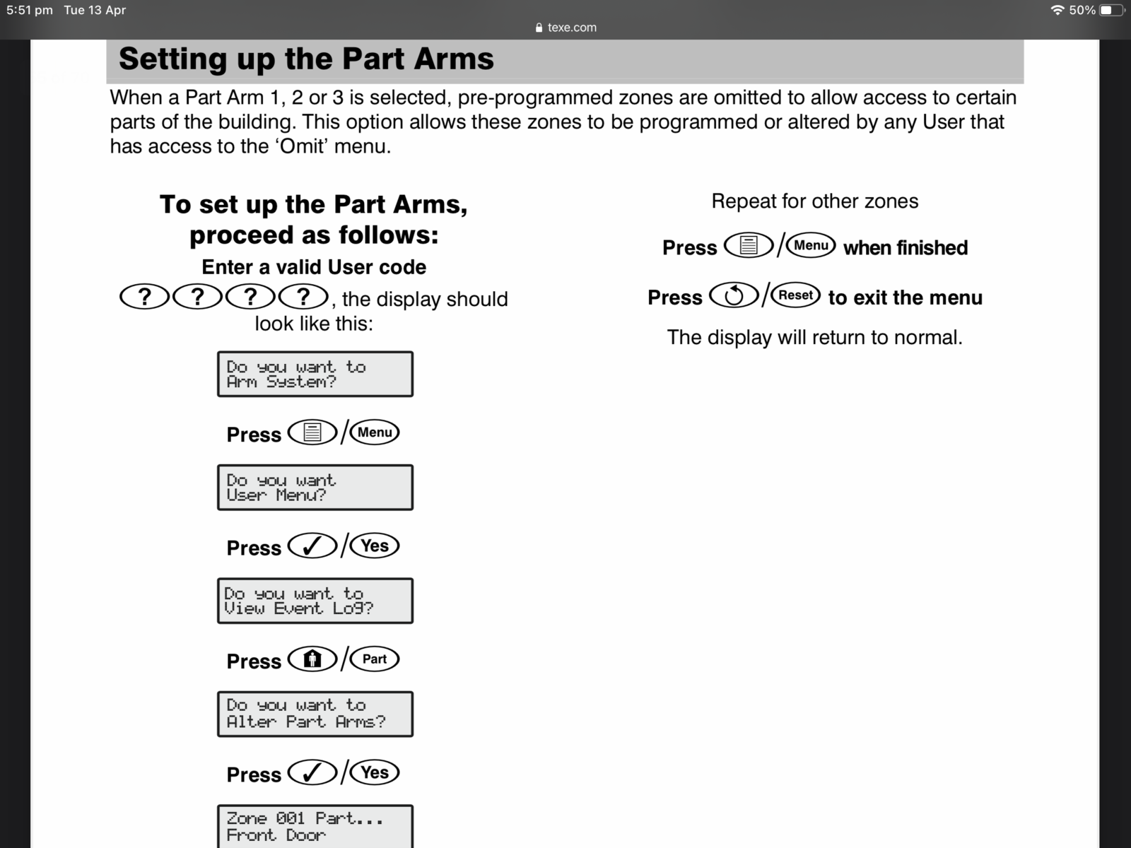

Hi I followed this from the manual 14FF115A-EB27-4BDE-AC37-C863DBCA9E81.png but when I access the keypad a few minutes later and it comes up with do you want to alter part arms I press yes then part arm 1 comes up I then press the part set button and it jumps to part set 3 which isn’t even set up. I also checked wintex and the zones are ticked for part set 2 and in the text it’s named as 2

Yes that all works as expected and also works in the app but I’m confused about the above part. If I go into the keypad and go through it I come to a part do you want to alter part arms” if I press part set button it jumps from part set1 to part set 3
Omit = Part Set 1
Chime = Part Set 2
Part = Part Set 3
Press No/ X to toggle Zone On (working in part set) Zone Off (omitted in part set)

you can scroll through the zones also I believe, have to say I tend to use Wintex or Keypad in engineers mode and editing zone setup attributes 1. Turn on or off options 345 (parts1,2,3).

Hello stupid here, many thanks @secureiam for setting me straight, so it appears i had everything set up okay from the start and for anyone else stupi like myself i went into alter part arms and part arm 1 automatically comes up first so i pressed the part button which i though would cycle through the options but as was shown it takes you direct to part 3, so all i had to do was press chime and up pops the part arm 2 page, feeling stupid now but thanks to everyone for trying to help me
