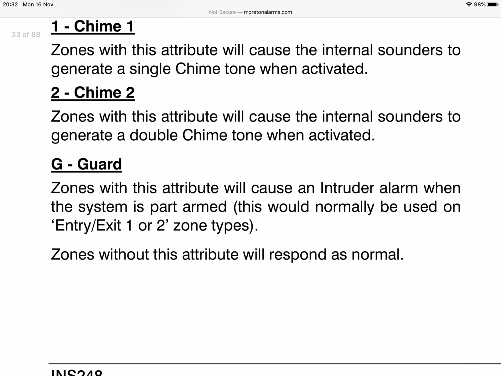

Top man thank you. Can I ask, can you have a door contact set as timed entry/exit on full arm (which I have currently) but then just as a guard option at night time part arm or can it only be one or the other?

I'm interested to know this answer tbh... good question
