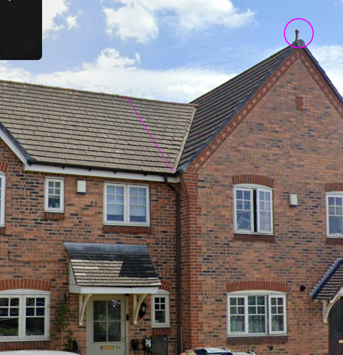

Hi all,
I'm trying to track down an intermittent sewer/drain smell in my house and would appreciate some advice.
The house is the middle property in a terrace of three houses, built around 15 years ago (UK).
The symptoms:
- Occasionally we get a sewer/drain smell downstairs, mainly noticeable in the living room.
- The smell seems omnidirectional – we can't pinpoint a specific source.
- It often happens when we flush the toilet or run the shower, but sometimes it occurs when we haven't used any plumbing ourselves.
- We never smell it upstairs in the bathroom.
What I've checked so far:
- The upstairs soil stack appears to be boxed in behind the bathroom wall near the toilet.
- In the loft above that area I cannot see any 110mm soil pipe or air admittance valve (AAV).
- There is no soil vent pipe exiting our side of the roof.
- However, on the roof ridge on the neighbouring property, there is a terminal that looks like a vent pipe (photo attached).
I also read somewhere that newer builds sometimes share soil stacks or vent stacks between neighbouring properties, so I'm wondering if that might be the case here.
My questions:
1. Does the item in the photo look like a soil vent terminal for a drainage stack?
2. In terrace houses like this, is it possible that multiple properties share the same soil stack vent, with the vent exiting through one of the neighbouring roofs?
3. If that is the case, could pressure changes when either house uses plumbing cause smells to escape somewhere in my branch pipework?
I originally thought this might be caused by a failed AAV, but since I can't find one in the loft I'm wondering if the system vents externally via a neighbouring property instead.
Any thoughts on whether this setup is typical, and where I should investigate next, would be much appreciated.
Thanks!
I thought all newer built properties had their own soil and vent pipe. As for the photo, it’s not clear but it could be. They may not have finished the soil pipe off (I found this once with a new build of ours (social housing), it just vented in the loft but they could smell foul odours by the front door (upstairs flat).
my thoughts
a sealed system cannot smell
any smell can only come from below or close proximity around or above
so iff all toilet bowls /traps and "U" bends are topped up [check this when you notice the smell] then i would suspect a leak being the cause in my mind would include a walk all around outside sniffing in case airflow is dragging the smell in from under floor or outside but purely a guess
Having done many newbuilds you will almost certainly be a AAV buried in the boxing in your bathroom.
On some sites the specifications were vent one in 6 property's all others Aav's.
Apart from failed aav's the real fun starts when someone with the correctly vented stack has a bathroom change and decides to loose the open vent!
Regulations say the Head of the (Drain) Run must be ventilated, so quite possible you are the penultimate property, and next doors is at the end, so has the Vent. Very unlikely to have shared internal stacks on properties of that age.
What is more likely, would be you have AAV's boxed in internally in the corner of the Bathroom/WC. Cant tell for you photo, but the obscured glazing gives away Bathrooms/WC's and any vent relative to those would be for the Drainage, others can be to exhaust Extractor fans, Radon Vents etc.
They are a PITA, we have a lot of issues with this type of thing when doing routine Cleaning on the drainage system, having done a section umpteen times before without an issue, someone comes along and caps the Vent, and then we cause a blowback from their WC.
