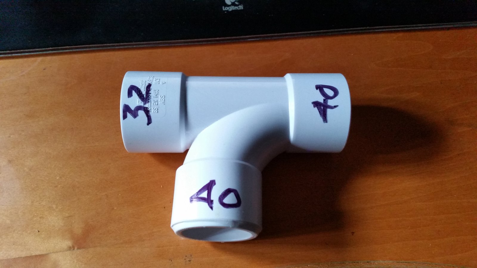

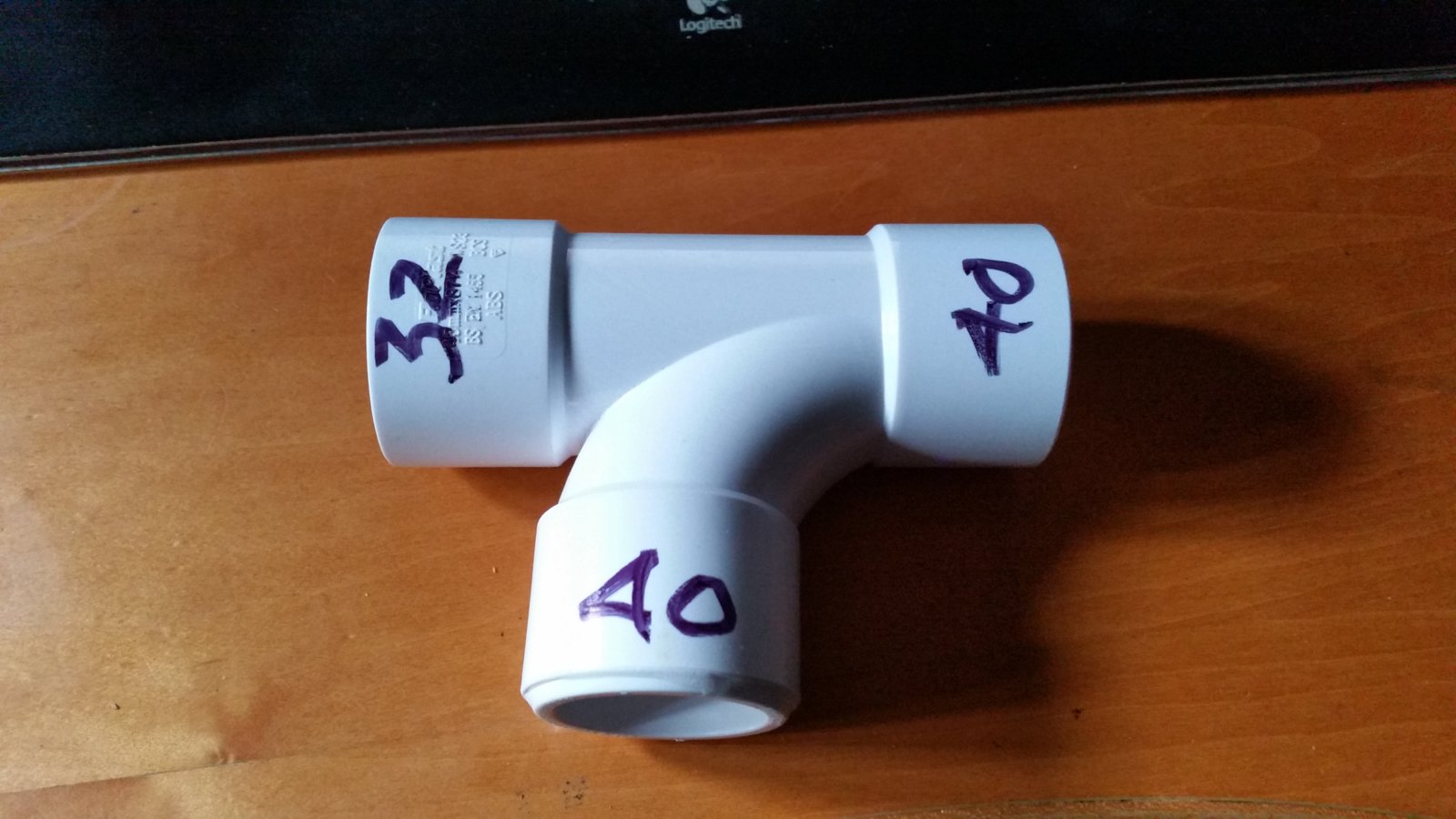

Can't find this Unequal T .... is there a techy reason?
5 Feb 2003
111
32mm sink waste needs to join 40mm shower waste and continue to soil stack. Cant find one anywhere.....am I missing something?

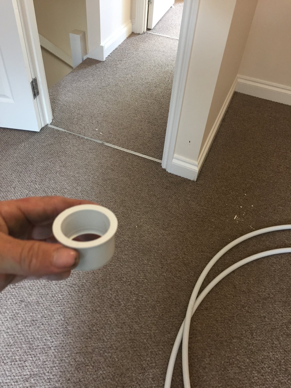

Yes, you're missing the reducer that's currently sat in the branch. Pull it out and put it in the hole you want it in
