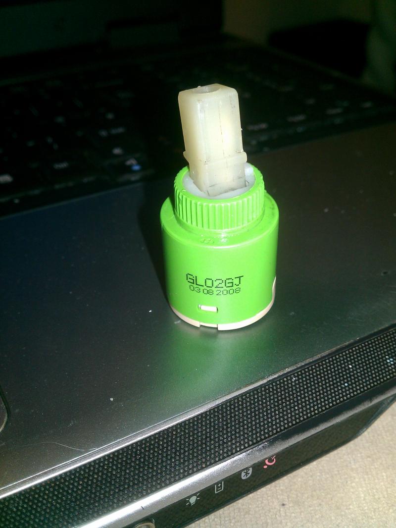

My bathroom mixer tap decided today that it would not turn off and instead ran constant hot water
I've blanked off the pipes and taken the tap off, hoping I would find a washer that had gone that could be easily replaced
Instead I found this - doesn't seem to be room to fit a tool in to turn the hex nut
I wonder whether the ring around / above it could come off but it seems fairly solid
Anyone seen anything like this or is it just time to bite the bullet and get a new tap?
[/img]
Does the tap handle pivot sideways or up and down ?
You pivot it up to let water out - it's in the 'up. position in the pic actually.
It spins around for hot/cold
Hope that makes sense - and thanks
What sort of gap do you have between the brass nut and the tap body ??
I've managed it - the circular bit above it unscrewed with a bit of force applied
I now know what has happened - I have the cartridge and it's very split though you can't see it on the image
Any idea where these might be sourced from?

I've done a bit of detective work and found the part number on a US site
Which when copied into Google led me to an ebay supplier in Burnley so I'll take the gamble for a tenner. Only one other supplier I found which was £25.
