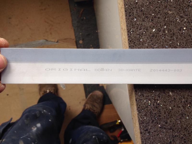

I'm having a bit of a mare with worktop edgings.
Firstly they're not the standard 1mm laminate edgings that you just impact adhesive on and nearly trim and file.
The problem is they are a thick plastic, probably 2-3mm thick and they are concave slightly, probably from how they have been stored etc. But this means that when you try to stick them the pressure of the concave just lifts it off the worktop (down the center) , even leaving it overnight with weight on it.
The next issue is you cannot use standard Evo Stick impact adhesive because the solvent literally eats at the pattern and removes it from the edging ( the pattern is on the inside of the edging for some reason.
So issues are, I'm having difficulty cutting and trimming it Because it's too thick.
And I can't even stick it to the worktop.
I'm going to get some unika tape and try that but I think I need to heat the edging up and remove the concave first.
Any suggestions?
Anyone seen this issue before?

If there is a pattern to inside edge why would it matter if it is damaged as it's not visible?
Can't see any worktop in the pic's?
Strip fits to side so how can you weight it with anything?[/b]

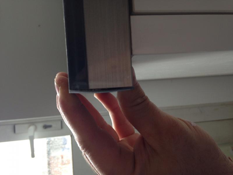

Foxhole - first pic is the front of the worktop - machined edge.
and the second is the back of the supplied edging strip.
Luckily it is my own house yeah. I had a fitter cut me the worktops but he hasnt come across these strips himself before. I have a few pals who are kitchen fitters and they too haven't seen it.
The only issue with it being me own house is I like things to be just right and any imperfections I'll be looking at it everyday! It will wind me up. Ha
Foxhole - the pattern, stainless effect at the bottom and graphite on top is actually printed to the back of the edging. Once impact adhesive is applied it strips the colour. I aren't making it up lol

If that's the worktop whats the dark strip half way down it?
The second pic looks like just cheap plastic angle not worktop edging?
What type of worktop is it.
Any clearer photo's would help.
According to manufacturer you will need hot melt glue, nothing else is suitable.
Adhesives
Doellken ABS edgebands can be processed using any standard hot melt adhesives (EVA, PA, APAO, PUR). Adhesives resist- ant to high temperatures, in tandem with the low-shrink mate- rials formula of Doellken ABS give good adhesion, even on edgebands of thickness in excess of 3 mm. Adhesives that are particularly heat resistant are recommended for applications in- volving high temperatures, in the vicinity of cooking appliances in kitchens or for exporting furniture in containers, for instance. Even before gluing, Doellken APS edgebands have very low shrinkage characteristics. Another good feature of ABS edgebands in this regard is their resistance to warping (dimensional stability). Softening of the material only occurs above 94 (± 2) °C (Vicat B 50).
When gluing, checks always need to be carried out that there is sufficient glue in the container to ensure constant temperature as it is being applied.
The working temperature of the adhesive varies between 90 and 220 °C depending on type.
It should be borne in mind that the thermostats in the hot melt container are often inaccurate and may vary consider- ably from the actual temperature on the application roller. It is recommended that the temperature be taken on the adhesive application roller.
Doellken ABS edgebands cannot be glued using ordinary white glues.
