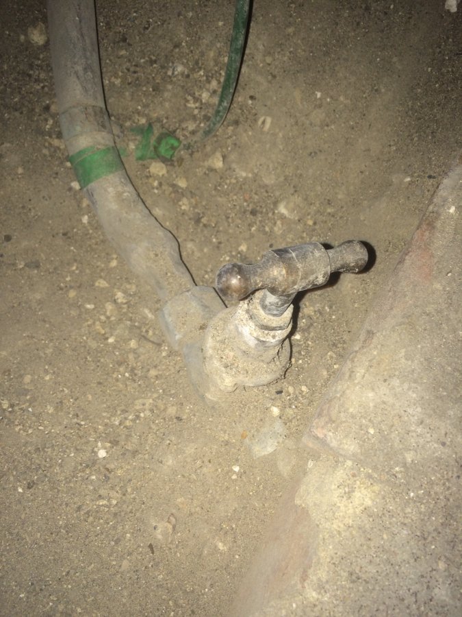

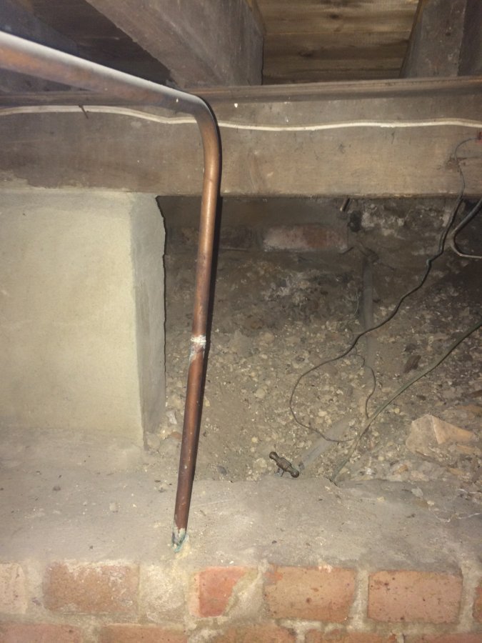

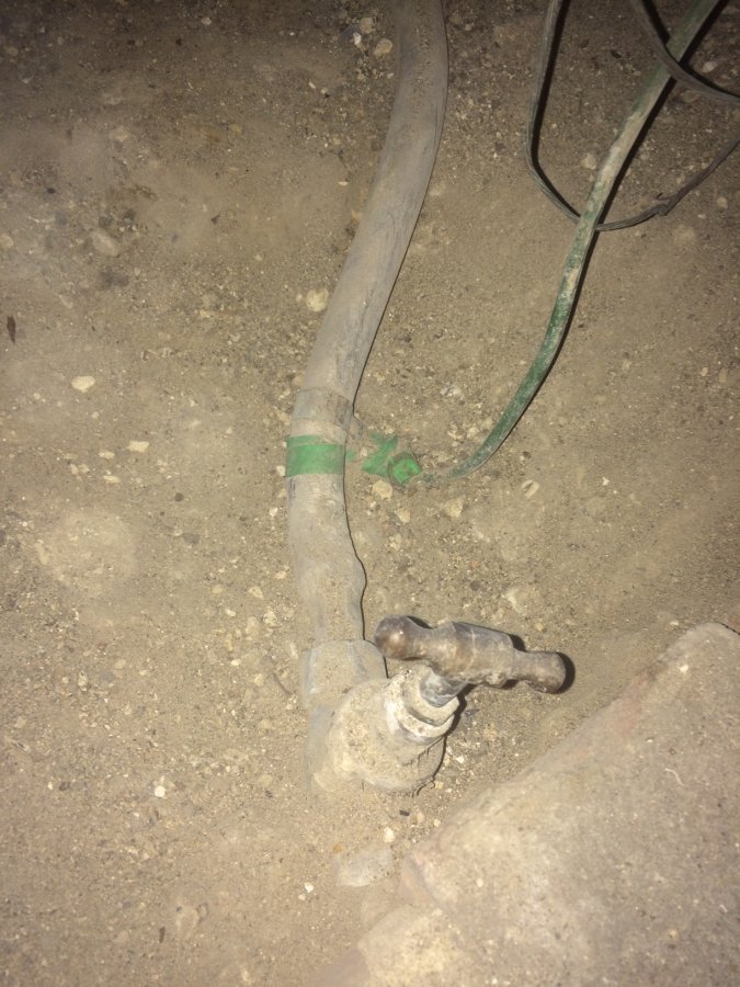

Evening all,
I'm looking to cap off the main incoming water pipe that comes into the house through the basement so I can strip out all of the existing pipe work.
The whole house is in the process of being gutted - with the basement being dug out deeper to make it habitable.
As you can see from the pictures the water comes in through a lead pipe, then transfers into cooper when it passes through the supporting wall. I've tried to turn the stopcock off - however it's not budging and I'm concerned about buckling the pipe if I apply any further pressure.
What would you suggest should be the best approach to capping it off and what should I be asking a plumber to do - I'm thinking it should be capped off somewhere on the lead section as the supporting wall will have to be removed in the future as part of the construction work?
Lastly - how much should I expect to pay? - I'm in Tooting.
Thanks in advance for any replies.
Matt

I know this doesn't help you with the immediate issue, but I recall water companies have some type of scheme to replace all the lead pipes. You could take advantage of those and get new plastic piping with a new stopcock.
1st thing would be finding the outside mains toby stop valve in the street feeding your property. Get that shut off and then the lead can be cut and a leadloc/plasson/philmac adapter can be fixed to the lead, a short length of 22mm onto a new stop tap. Not a huge cost attached to all of that, not sure about Tooting's rates tho.
Thanks for the advice / replies everyone - the plan is to replace the lead pipe completely, and re-route it, however for the time being I just need a short term fix to enable the basement to be cleared.
Matt
Those stop cocks can usually be persuaded to move given a bit of care, and gentle manipulation with the correct tools.
Loosen gland nut and maybe squirt with wd40. Then equal and opposite force to wind and unwind it. Won't be an immediate thing though.
At least you have access to either side of it.
