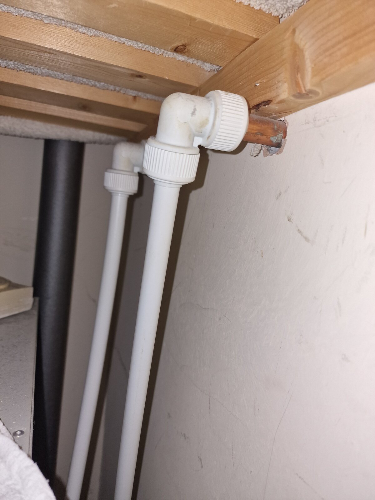

I'm looking to get rid of a shower, redoing bathroom and decided it's no longer needed. Unfortunately when it was fitted about 5 years back, it looks like the guy that fitted it didn't bother to fit isolation valves so can anyone advise what I need to buy to cap this, unsure of the pipe size etc.
Can't tell for certain from a picture ,but it is very likely to be 15mm ,you need to Measure the pipe diameter and buy suitable size stop ends or isolation valves.
Thanks Terry. Good eye, just measured and it is indeed 15mm. Will have a look on screwfix and get a suitable stop end.
Edit - all done thanks.
