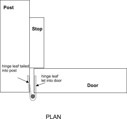

No, simple as that. The frame should have been made to suit the door (not difficult) and the door hung with equal spacing all round.
Re your fire doors with hinges recessed into both frame and door and the ones where not recessed to both or either, this is a bit of a grey area. In times past it was the done thing, today, well...
Much depends what hinges were specified, if these were specified at all. For instance - flush hinges (suitable for light internal door only) are not recessed. Butt hinges are always recessed into the door, but weight of door would dictate if it should be recessed into the post. I always tailed my hinges into the posts, regardless of weight, but with no regs. covering this, that I'm aware of, the whole issue at best would be arguable in my opinion...pinenot :)

Here's how I tail in my hinges to the posts.
...pinenot :)
Positions door perfectly and ensures the door is held in place.

Speaking personally I set my door clearances at 1/8" (3.5 mm approx) for internal 35 mm doors, fire doors (normally 45 mm thick) 3/16" bare (4 mm approx) both with a leading edge taper allowing it swing clearance.
My answer to your question therefore would be no, I don't think that's acceptable as youv'e described...pinenot :)
