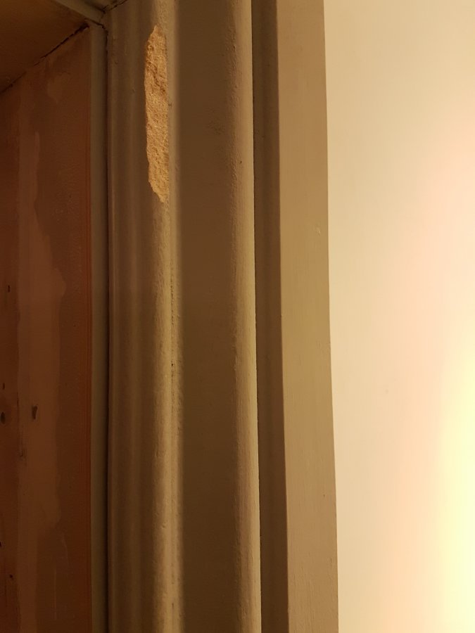

Had a so called Carpenter in today to fit 4 internal solid pine doors. I've not paid him yet as he's due back on Wednesday to do 2 more. Can I ask people's opinions on the level of workmanship on display - I think it's awful and I suspect I'm going to have to fork out for new doors. I've not paid him yet luckily - main gripes is that where he's planed the doors, he appears to have pulled the plane off the door at various points resulting in steps on pretty much all 4 sides of every door.

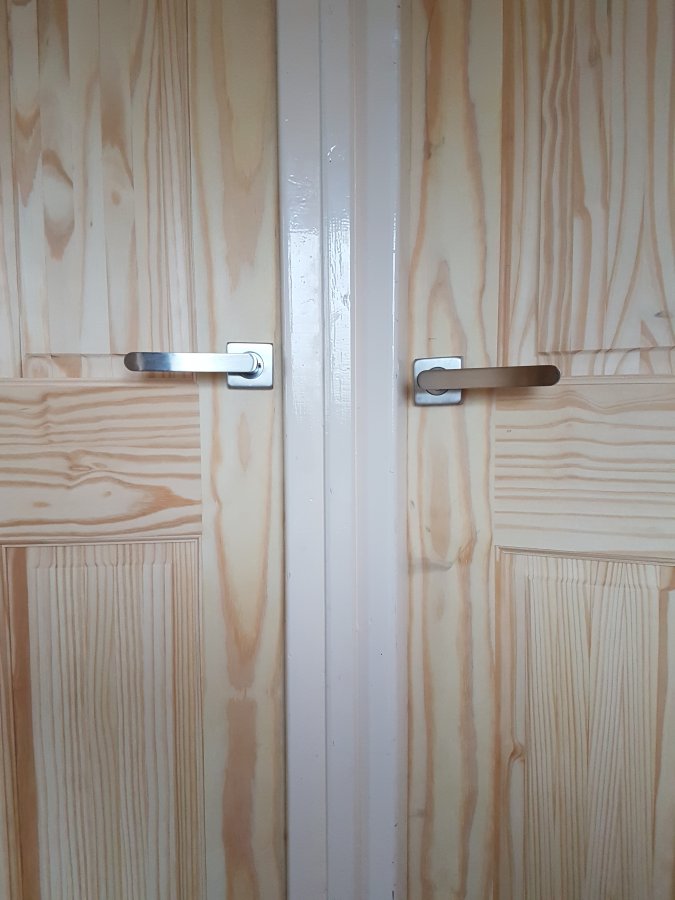

He's also carved a chunk out of the architrave and two handles are at different heights - I'm so peed off.

Absolutely rubbish workmanship. The door handles would need a larger size (plus a larger bolt mechanism) to cover the new hole positioning. The door that has a widening gap needs the hinges adjusting, but you'll have a large gap one side or the other once it's brought evenly upright. The door with the plane digs would need planning down a bit more before you could judge whether it's too narrow.

He should have been aiming for an even gap on three sides - ideally 2.5 to 3mm in a domestic setting - and that includes the top. Planing in with a power planer I can understand, we all do it, but the steps shouldn't be large and I always fair mine in with a nice sharp block plane so they are no longer visible. It takes only seconds. Adjacent handles must be at the same height as it can be visually disconcerting - whereas if they are at different ends of a corridor a minor difference isn't that noticeable. Ding out of the architrave can happen in transit, but you either use another piece of at least fill it with 2-pack and sand it in so that it will paint out because no deco ever will. It may be correctable, but it depends on whether or not he's willing and able to do so.

To level the handles you will need some different handles with longer plates.
