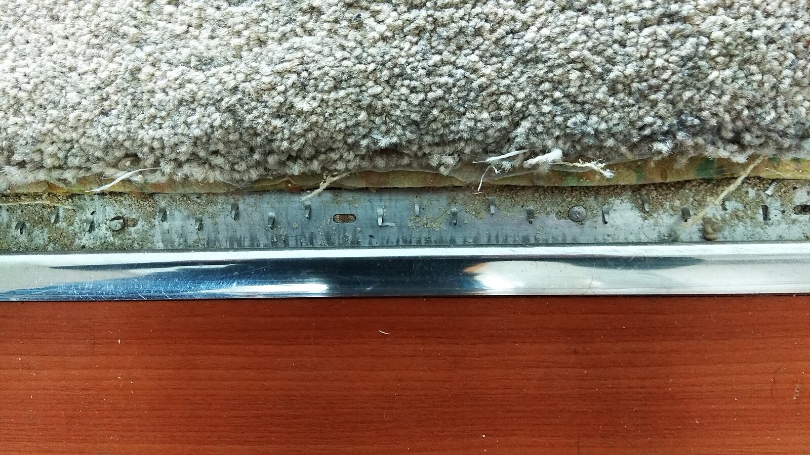

Hello,
I've tried lifting the metal grippers under the carpet as some had flattened (pic 1).
I then tucked the carpet under the grippers using a flat-ish tool (pic 2).
But it comes loose after about a week. Do you know what I might be doing wrong please? Should I try something like double-sided carpet tape to help secure it?
It’s called a naplock. A doortrim not gripper. You could do with some carpet spray and a knee kicker to kick the carpet into the trim so it gets trapped on the spikes.
