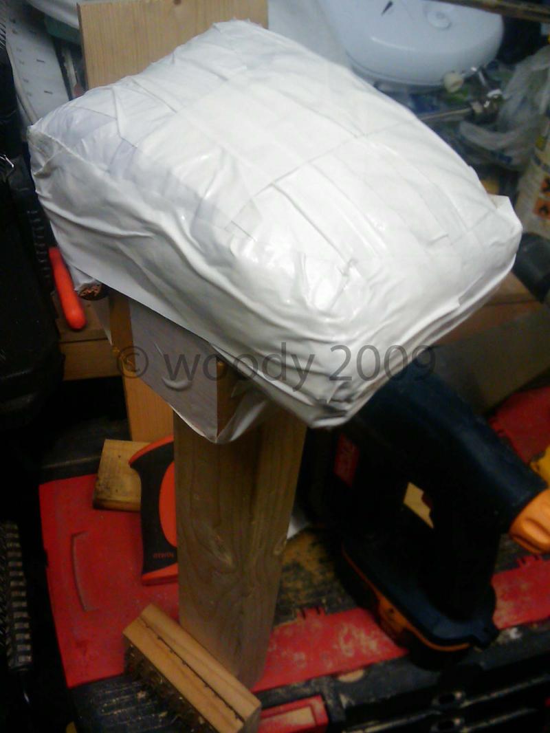

Is it really necessary to use a carpet kicker to fix carpet down [in a bedroom]?
If so, in true DIY fashion, could I make one out of a block of wood, some pieces of gripper and a rubber pad? :roll:

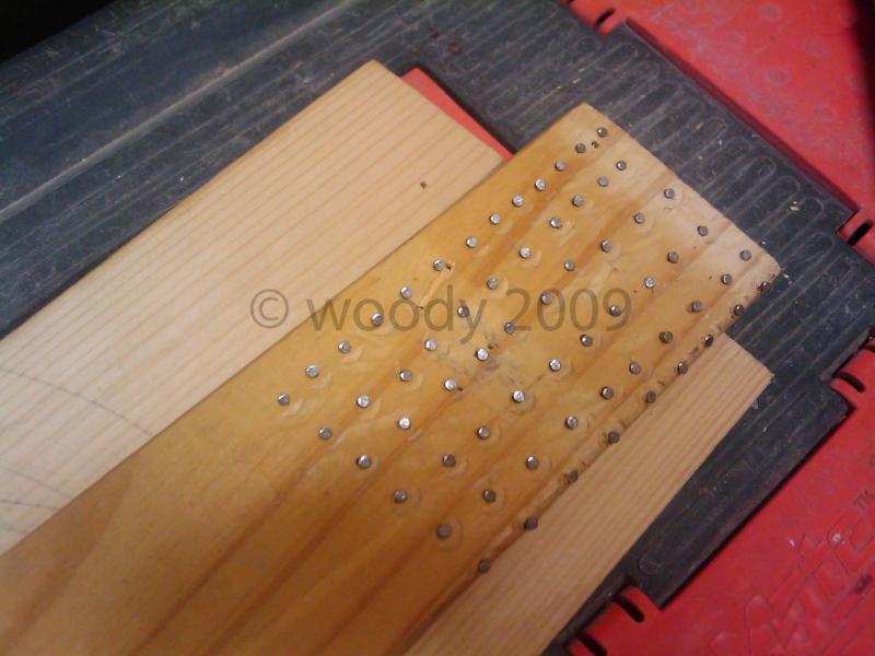

My father managed for years with a home made version.
Six sharpened 3" nails through a piece of PAR 2x2 PAR with a piece of board on the other end for his knee.

LOL ..... coming soon to a forum near you will be my home-made carpet stretcher!!
I'll upload the pics  8)

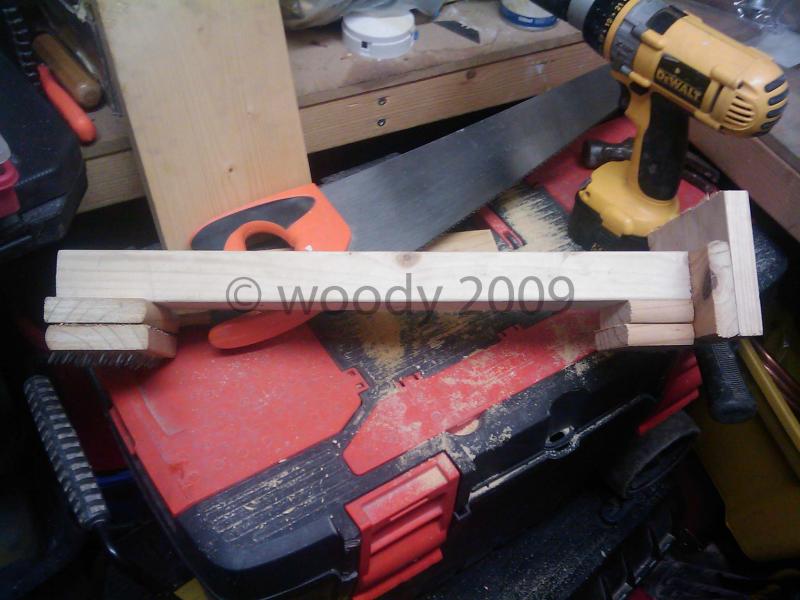

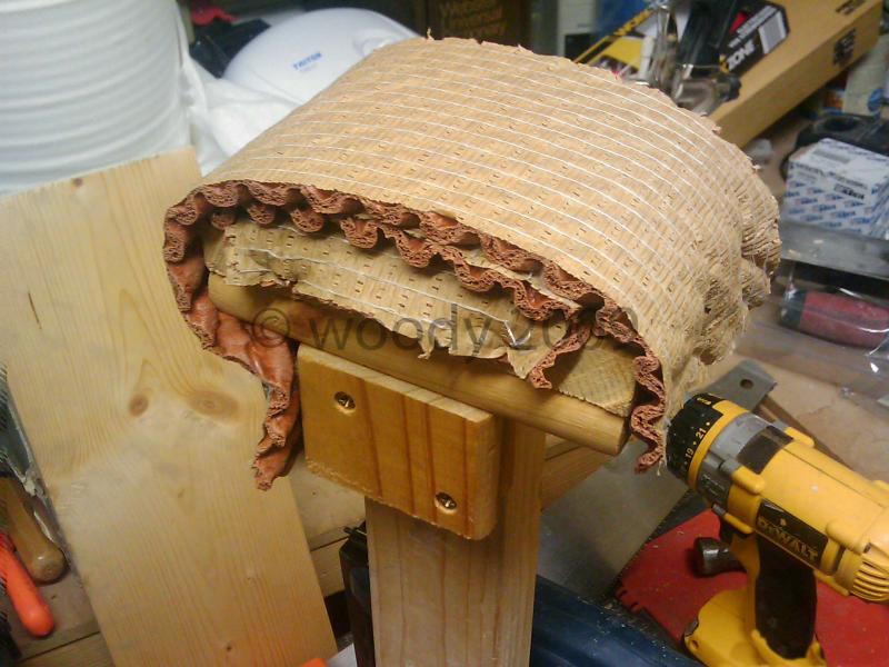

Say hello to my leeetle friend
Nothing posh, just a quick 20 minute, et voila!
