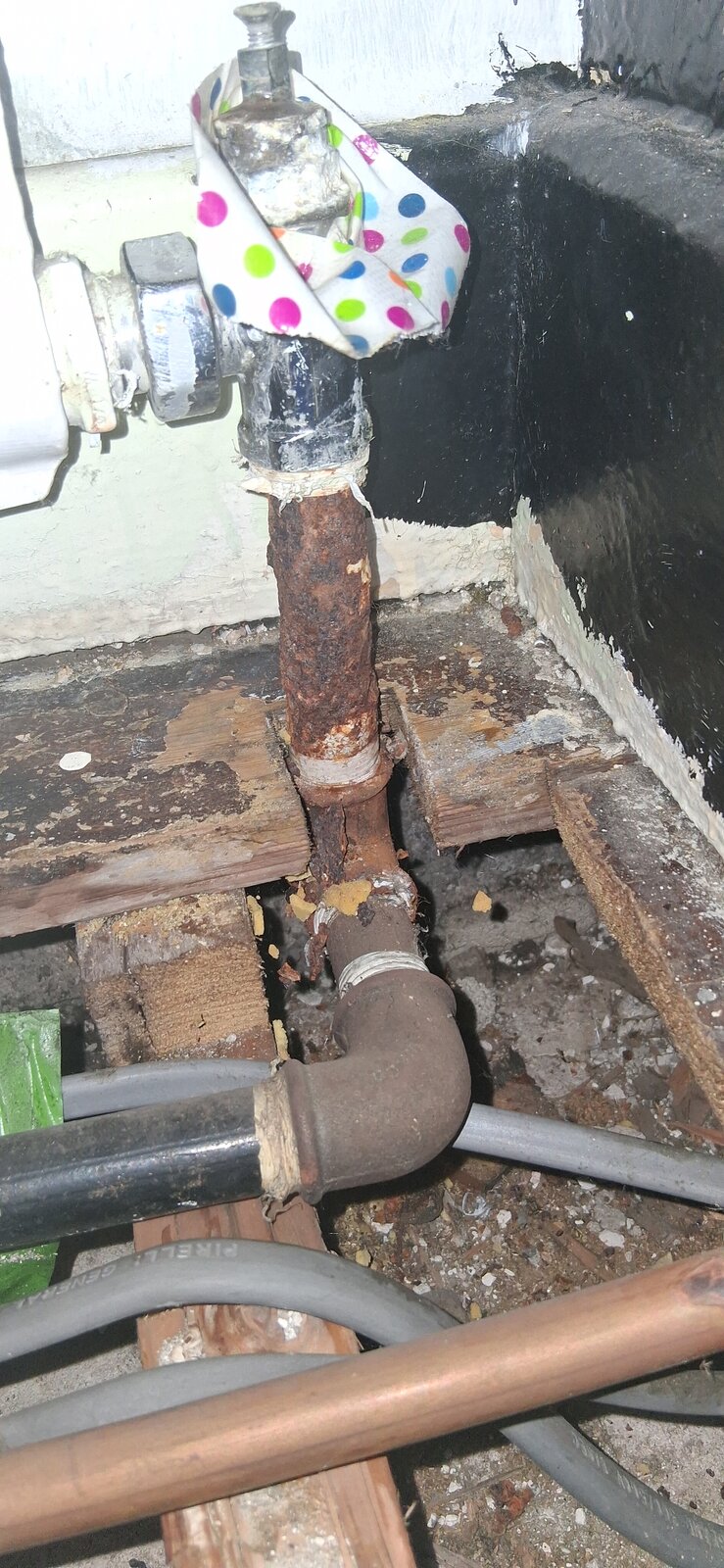

Steel pipes to radiator valves (90 year old house) are very badly corroded. I want to replace the final section, joining to the old pipe which is in sound condition further back under the floor. What's the best way to do this?

Malleable iron fittings.
You'll want adapters, possibly 3/4" to 22mm but you need to check the sizes and what the rad valve intel fittings are too as they aren't standard compression.

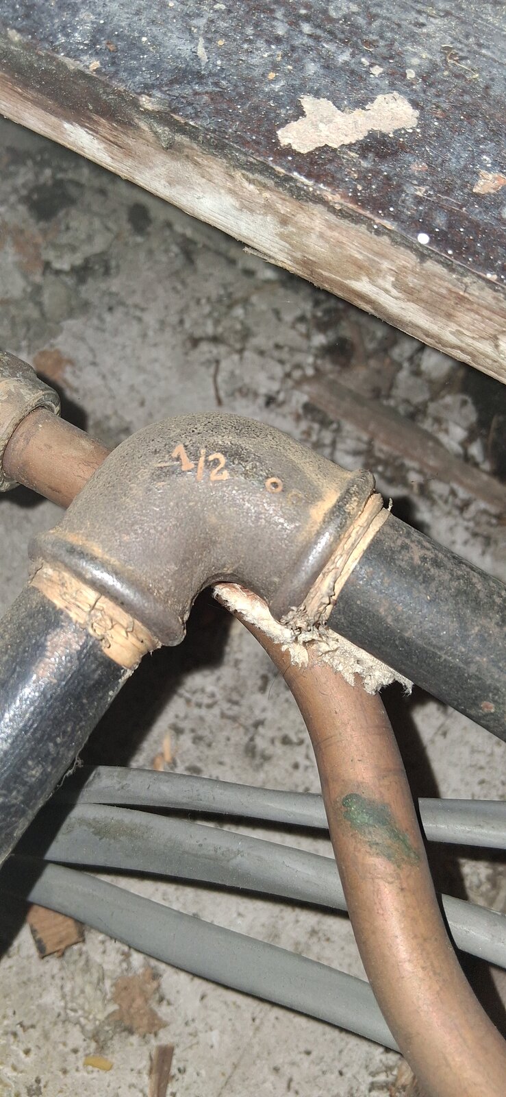

Thanks madrab. It's marked "1/2" on an elbow further back, picture added. I could just replace with malleable iron/steel fittings then?
Yes - I'd probably look to take that rusted vertical pipe out, the bottom elbow and the horizontal piece, then fit a 1/2" >15mm compression coupler into the elbow, then a piece of 15mm copper along, a soldered elbow and then a piece of 15mm copper up to the valve.
I'd also look to change the rad valve to a standard 15mm compression angled valve at the same time.
