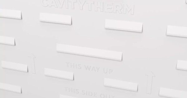

Would these be okay then - full fill 100mm as you mentioned above.
Cavity is fixed at 100mm
That will do it. With a standard thermal block internal leaf that should achieve a u-value of 0.17. (The minimum is 0.18)
Yes we've just used them on our current build. Horrible to cut, horrible to install, very expensive and add much extra time to the whole cavity insulating process.
