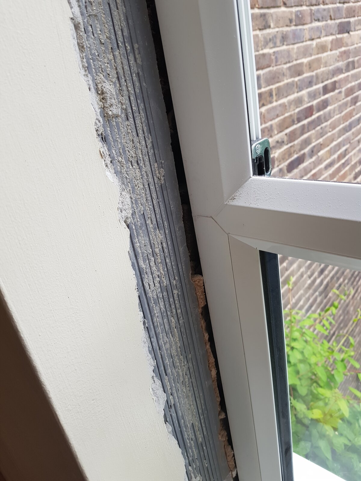

Hello, first time poster. Had some windows fitted by the window company, afterwards I had my builder strip some blown plaster in the reveals. As per picture the window is positioned forward of then cavity closer and there is a gap. Is this likely to cause an issue? should the window be flush to the closer or overlap it?

Yes the window should ideally be at least 30mm over the cavity closer.
However they may have not have quoted or specificed for this - especially if the original window was in the "wrong" place, or the reveal plasterboard was insulated (doesn't look like it).
The issue it can cause is essentially your reveal plasterboard is attached to the outer leaf brickwork and the plasterboard is the only barrier to outside temps. This is an cold bridge and you can get condensation / high risk of mold here as the cold surface meets your warm room - but it varies on house use, temps etc. Also if the brick fully saturates from driving rain (doesn't look like it will, the area looks sheltered) then that can also track moisture inside.

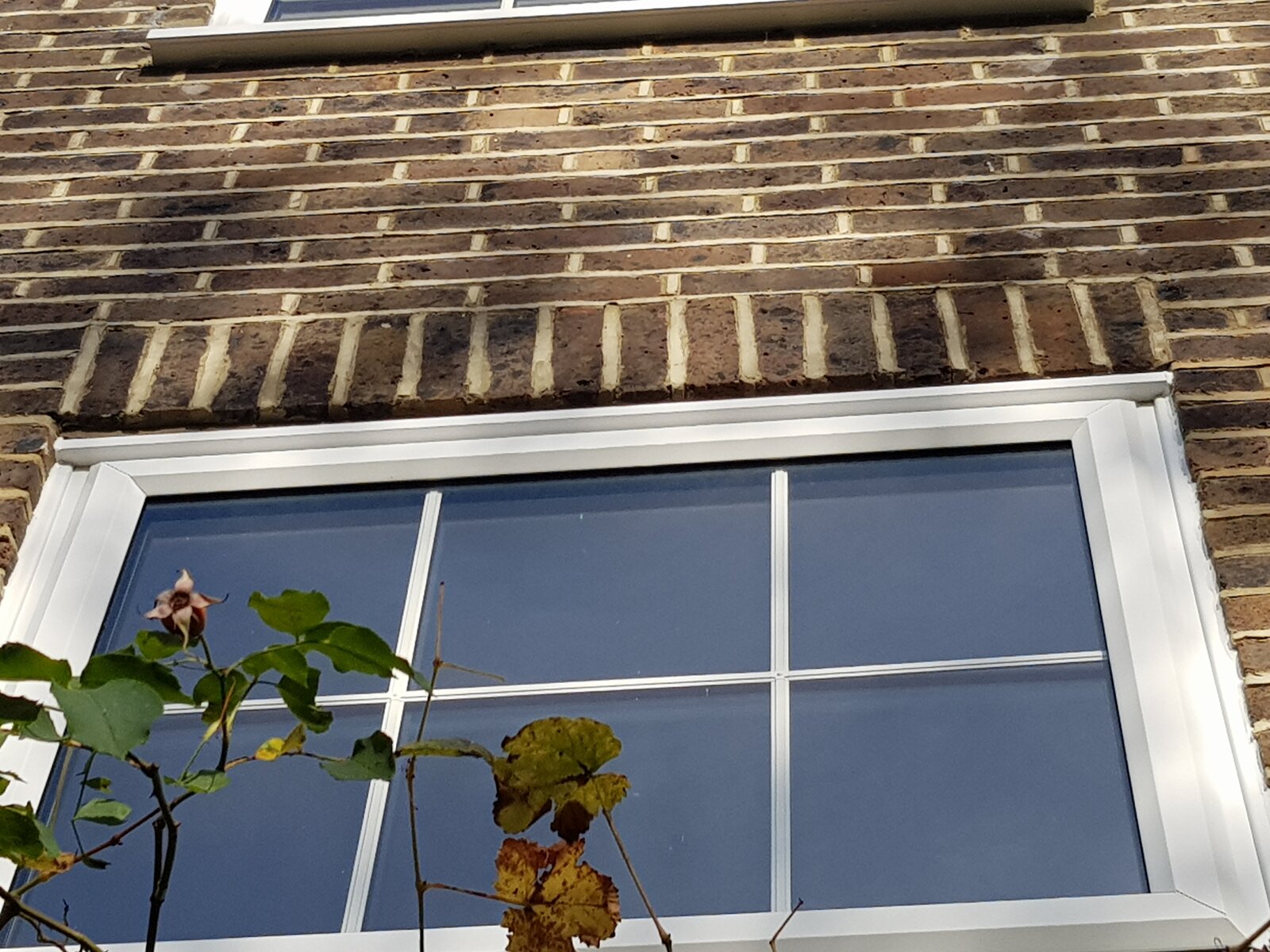

I attach a picture from the outside. See the top bar seems to jut out on the RHS. The brick on the side reveal is about 3cm on the left, and just over 1cm on the right. So looks like it as at an angle. We have the issue on the bottom corner on the RHS. I damp arc appeared in the corner.
I just tried spraying the window from with a hose from the outside, after about 5 mins water was seeping in that same corner, water was actually coming onto the inside window sill. Presume that is not supposed to happen? Spraying with a hose from under I guess is not recreating rain conditions but I would expect them to be water tight?
