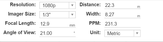

I completely agree with the above. When I used the link you sent through, I got the following metrics:
So, based on the above and the information I provided in the earlier posts, are you able to make a recommendation?

so basically what this is saying a 12.9mm lens (fov 21 degrees) can just about be used at a distance of 22m away to view an 8m wide strip at 230pixels a meter just short of identity criteria of 250 pixels a meter in a non challenging environment. I am guessing the field is much longer than 8m?
If the field was 80 m long and 22m away from where the camera is mounted and you wanted to cover it all you need 10 cameras????? I am guessing the field is much bigger.
or your telling me you want to recognise someone 22m away distance from mounting to edge of your garden and the garden wall is 8m long ish?

so the end of your garden is 12 m from the house, how wide is the garden at the end?
so a 4MP 1/3" sensor lens 2.8 fov 81.20 at a distance of 6 Meters away would give a 10m wide strip at id resolution of 261ppm (identify in a non challenging environment).
at 3m away this would give a 5m wide strip and 527ppm. (Identify in a challenging environment)
at 12m away you you have 130ppm at over 20m wide. (Recognise)
250-500ppm is identify in good to challenging conditions.
125ppm is recognise someone you have seen before
62.5ppm able to observe and pick out distinctive clothing
Your not going for inspect which is 1000ppm that's basically the image taking up the whole of the 1080pixels
So you need to understand what area your viewing at what distance away from the camera in a straight line, realistically the real distance is longer due to the mounting hieight, too highly mounted and you going to get tops of heads not faces.
