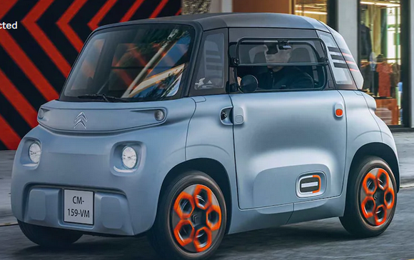

The same with EV chargers, it seems using a 13 amp outlet does not need any special notifying but a 32 amp does, but the risks of loss of PEN are the same with both, also the 6 mA DC detection and types of RCD. I have heard it said the 13 amp version is only for emergencies, however I know people in rented accommodation who's only option is 13 amp at home, or travailing to local charge point, and even the local charge point is now turned off at night, due to people sitting there plugging the car in every 15 minutes which they could get power for to allow time to set up charge on app, so their only over night option is home charging.
Plus if you can plug in a quad, then why not a car? I note with the quad they have a EU standard plug, it does not say if German or French, so those with electric quads, have no option but with EU sockets or adaptors. Which will be 16 amp although I think the quad only draws 10 amp.
So this 1678103407475.png needs a 16 amp socket or adaptor, and unlike the lawn mower which is unlikely to be used in the rain, and is class II, this is likely to be parked outside in all weathers, and can't plug directly into EV charging points or 13 amp sockets without an adaptor.
