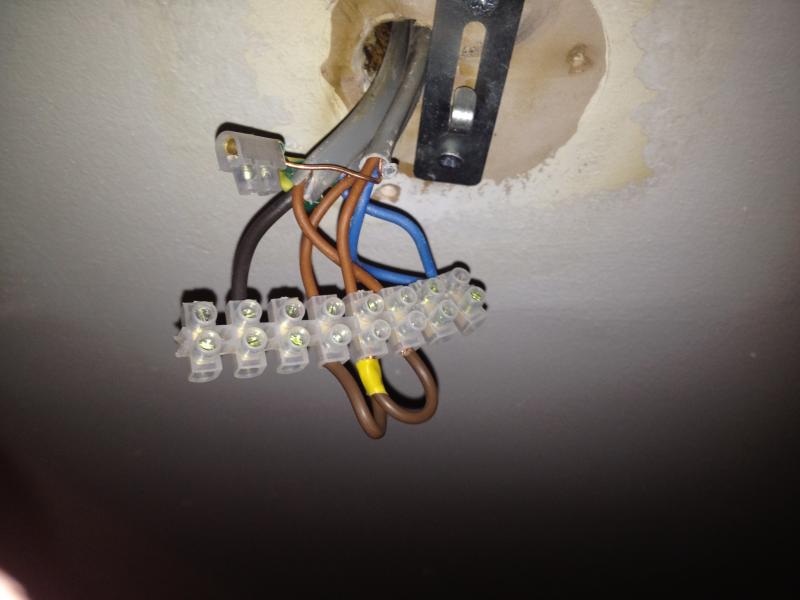

Ceiling fan wiring,
Is this correct (NO EARTH ON DIAGRAM , I KNOW WHAT TO DO WITH EARTH)
Sorry for the scruffy diagram:)
Yes the diagram looks okay - though I am not sure what you mean by 'ring'.
You will normally find the loop containing two cables (2 loop live, 2 neutral and 2 earth) and live/switch live. Or if at the end of the circuit - one cable the LNE and live/switch live.
Lol, i thought it was loop again, but dont know why i put ring, Thanks for the reply , much apreciated :D
Sleeve the earth wire - what size are those terminal blocks?
To be tidy I would use 15Amp terminal blocks and use just four.
You should be able to put the three live into one terminal block - the two neutral into the second, the earths into the third and the switch live into the fourth.
Then on the other side of the block connect your switch live to your lamp live, the neutral to the lamp neutral and the earth to the lamp earth (if it has one).
Ok thanks for the advice will change that when i get some more connection blocks
