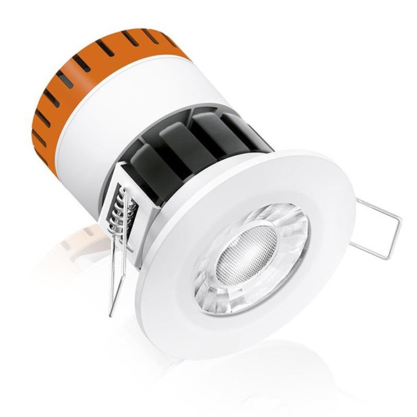

I had Aurora Enlite E8 LED downlights fitted in my kitchen and bathroom about 2 years ago as part of a complete house rewire. Ever since, and quite regularly, these units have started to flash continuously requiring replacement.
Is the lifespan of these units known to be short or is there something else that can be causing these failures? As you know, these units are quite expensive to buy so regular replacement is getting quite expensive. Perhaps someone can suggest a more reliable unit with hopefully a similar bezle or one where you can use the Enlite bezles.

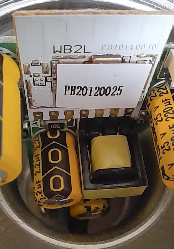

As to why they fail, I have looked inside the bulb, 20220603_113820_1.jpg and far to complex to work out what went wrong, however I have debated with my son, he is one on step ladders, about if surge protection devices (SPD) is really required, I have them, he doesn't and I have less bulb failures to him.

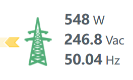

I can due to having solar panels view the voltage, frequency and consumption at moment 514 watt 246.8 volt and 50.1 Hz. I don't have a smart meter but would think they do the same, UK voltage should be 230, but it is permitted to be 207 to 253 if your supply is on the upper limit then can see lamps will fail quicker, never seen how a smart meter displays mine looks like this 1698620361660.png plus all the bits about battery level and how much solar today which was poor. Why they say 230 volt I don't know, rarely below 240 volt.
