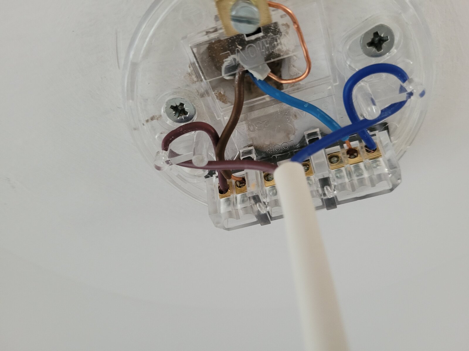

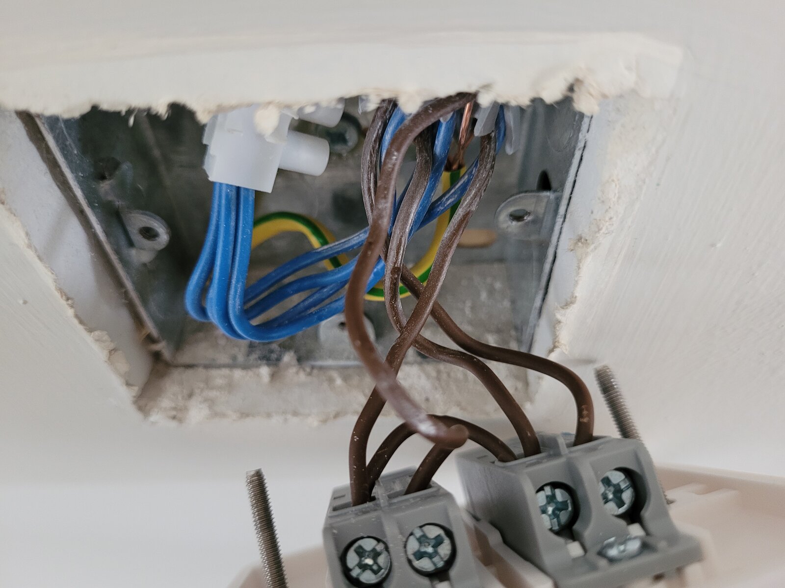

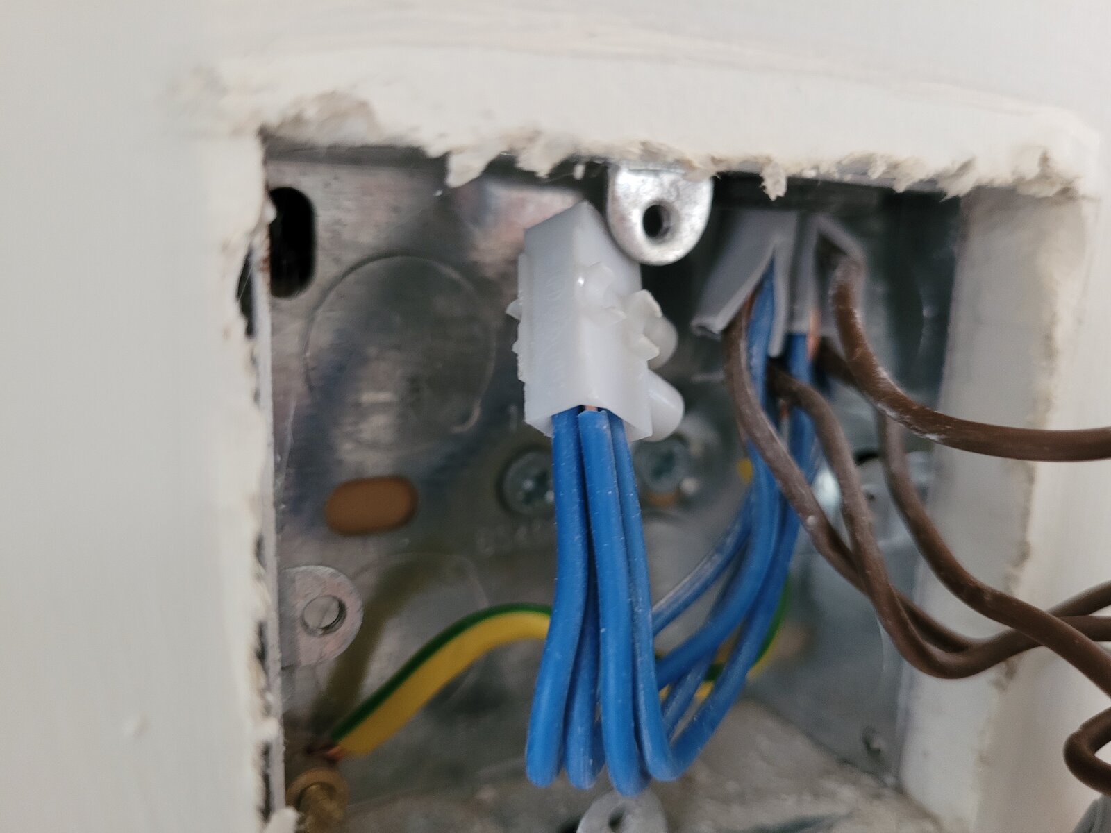

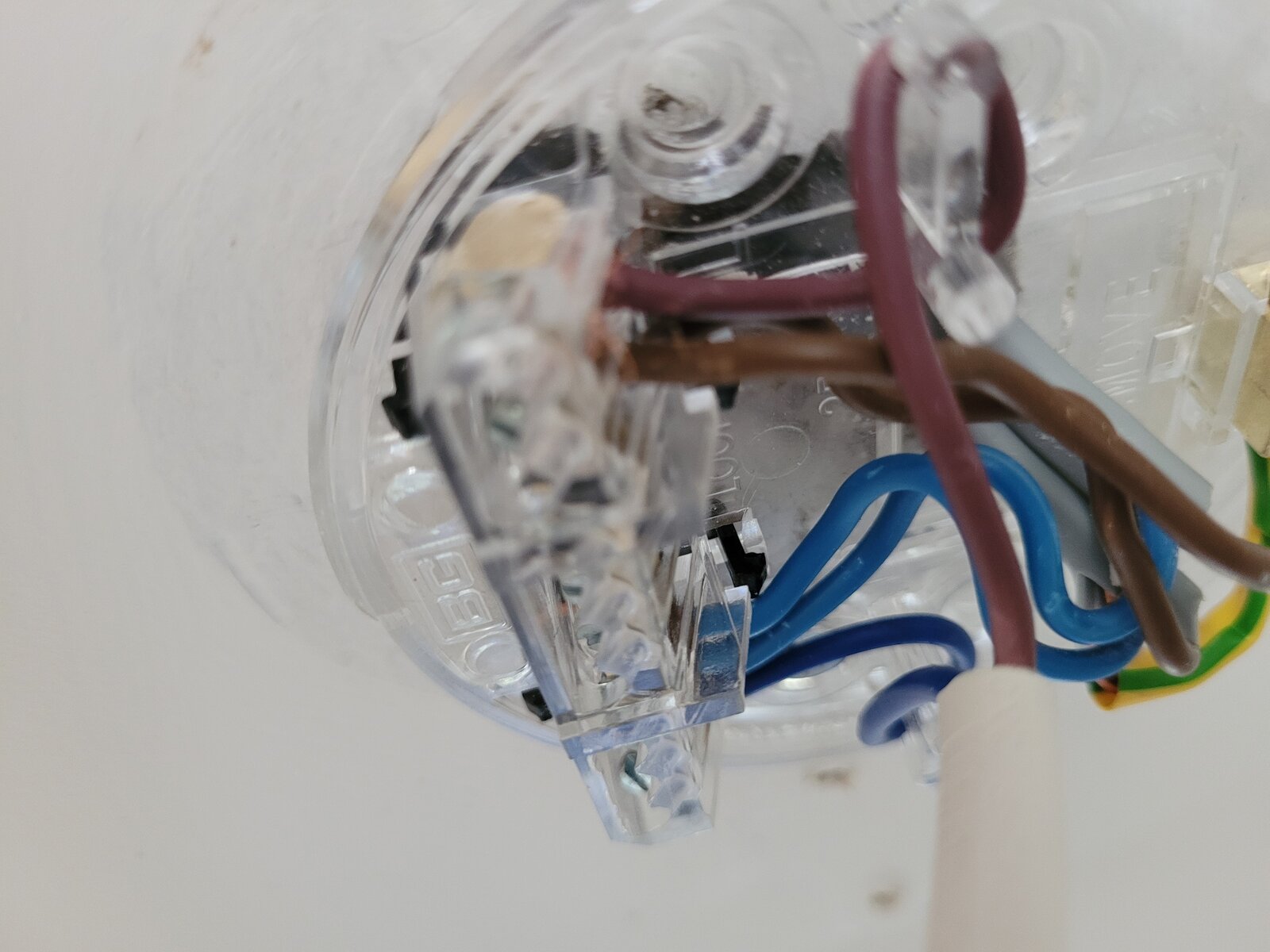

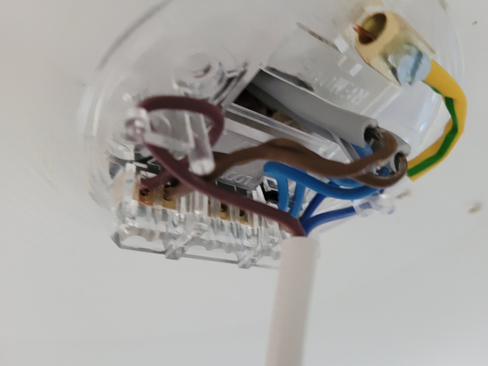

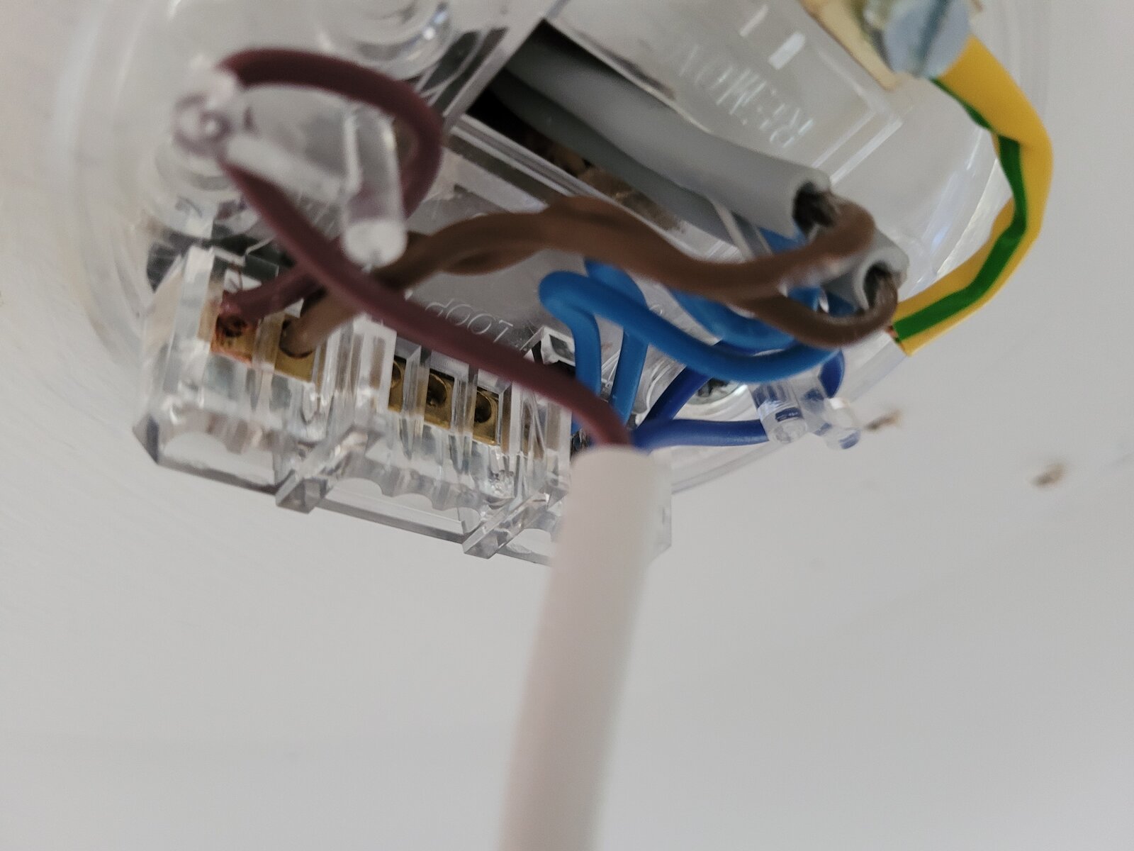

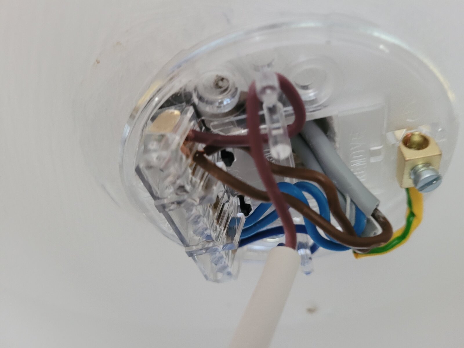

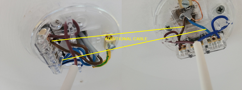

Here are some pics:
- first two show the wiring behind the wall switch
- next four show the wiring at the ceiling light at the centre of the lounge
- last one shows the wiring at the ceiling light on the other side of the lounge

You cannot do what you want without installing another wire between the switches and one of the lights.
C
Can you please expand wrt to which wire and how we come to that conclusion? Just for me to understand. Thank you
There are only two switched-live wires leaving the two switches and there is an additional cable linking the first and second lights.
Therefore there is nothing independent (at the switch position) that a third switch could use to separately operate the second light.
