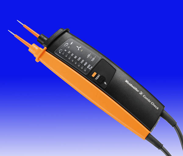

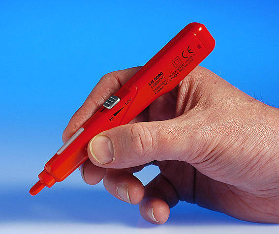

Don't use an "electrical testing screwdriver" - get some proper test equipment.
Yes you are correct about the wiring of the rose.
Shame you didn't observe which black wire was on its own before you took the rose off.... :LOL:
Thanks ban-all-sheds, what proper test equipment would you suggest?
and observing beforehand!.. I wish you'd told me that earlier. ;)
In decreasing order of preference (although it's useful to have all of them)
1) A multimeter
2) A "combi-check" tool like this sort of thing:
3) A proximity voltstick like this sort of thing:
Excellent. I'm borrowing a multimeter this afternoon.. many thanks for the knowledge & pics. :)
