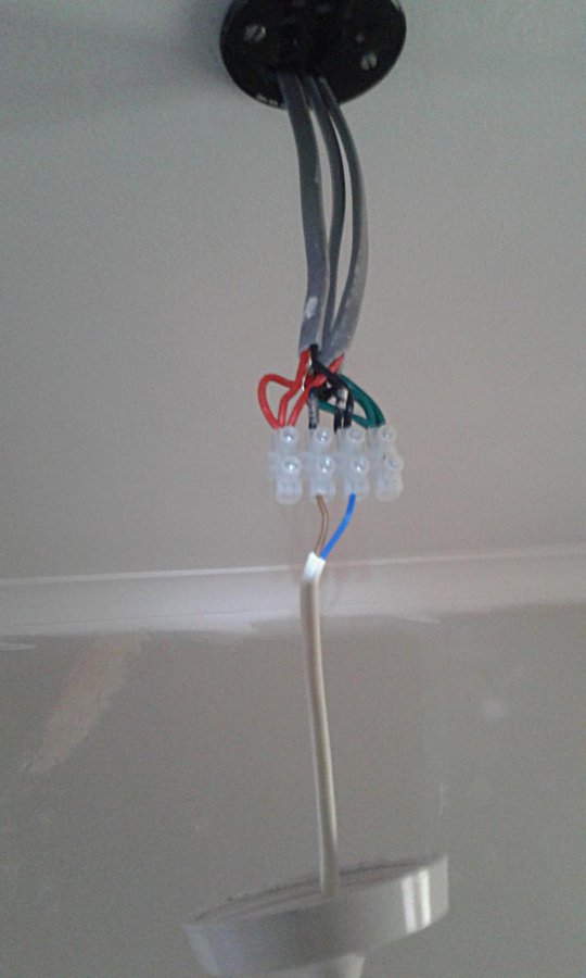

Looking at the terminal block in your "room 1" photo in post #28, what would you call each of the four connections, from left to right?
First: live
Second: ???
Third: ???
Fourth: earth
Second: switched live wire
Third: 2 black neutrals

The photo in #28 is no longer valid. I changed the wiring: brown to switched live and blue to neutral.

Latest. A voltage test in Room 2 shows only 35 volts on the multimeter.
There are at least a couple of possible reasons for that sort of reading:
- It's the result of capacitive coupling or resistive leakage in the cables. A tiny current is leaking from one wire in a cable to a neighbouring wire; you only see a reading on your meter because the meter is very sensitive. This is normal. You'll probably see that the voltage fluctuates quite a lot as e.g. you move the wires around. One way of making it go away is to connect a load, i.e. a lamp.
- It's because you have got things connected in series, and the 240 volts mains is divided across those things, with this one seeing 35 V and the others seeing (about) 205 V.
Tell us exactly what you're measuring. A photo might help.

My measurement is from the reds to the switched live wire with the wall switch ON. Here is the photo.

Tested between the reds and the switched live wire with the wall switch ON. I know I don't fully understand but I am trying to the best of my ability.
This is with the circuit on at the fuse box, is it?
What do you measure between each terminal and earth?
