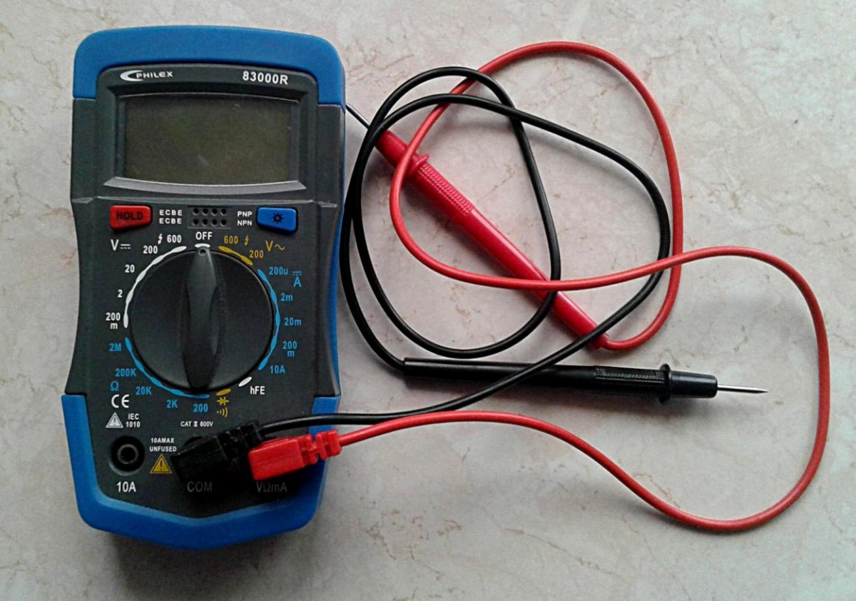

Finally got myself a multimeter. What is the setting to test continuity of wires? Please advise. Thanks.

Got one! Can you now please tell me how to use it? What is the setting to test continuity of wires? Thanks.

Thanks but all I need is advice for simply testing continuity of wires and especially to make sure that the switched live wire is in the correct connection. I am trying to simplify my task and cut down on reading and watching videos which, BTW, I have already done plenty. Thanks again for your help.

OK. I'll try to help, a little.
I asssume the thing has batteries in it and a display is shown when its switched (see "switching on" in the manual)
With the leads in the sockets per your picture, move the control knob round to the half past 5 position (the symbol that looks like a speaker between the 200 and teh hfe position)
touch the two test leads together, you should get a beep. That shows continuity. That is how you test continuity.
Simples

Half past 5 position"...sorry...I don't follow you. And I can't see a symbol looking like a speaker either.
Imagine the control knob is a clock face with 12 at the top and 6 at the bottom. The setting you need is just before - in thr sense of how the hands of a clock turn - the 6 o'clock position. The symbol with a series of curves getting larger to the right id supposed to indicate sound.
