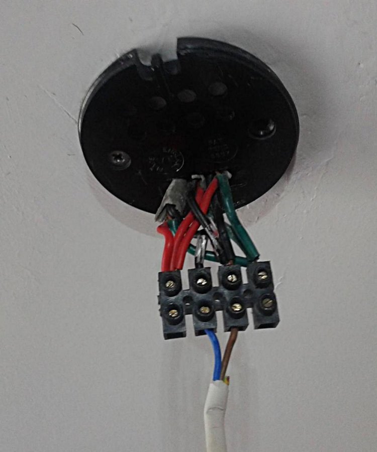

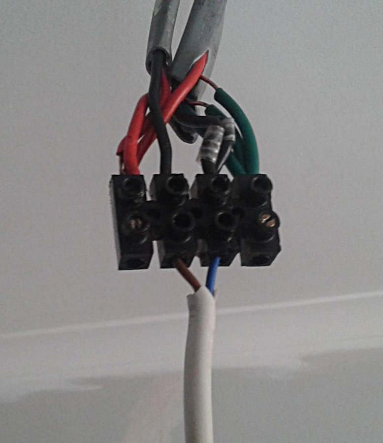

Switch wire. 2 of 3 are live!
If you really have tried every permutation and nothing blew up then it seems like there is no live at all to that rose. There are several permutations that would cause a short-circuit. This should be trivial to check with the right equipment. If two of the black wires really were live then connecting either of them to the other black wire would be bad. Time to start again and follow the instructions more carefully.
No. 2, as No. 1, 3 red wires and the switched live have juice. The two neutrals are together and the three earth as well. Beats me that it doesn't work.

No. 2, as No. 1, 3 red wires and the switched live have juice. Beats me that it doesn't work.
If so and now properly tested, there are still all sorts of reasons why no light. The obvious one being that there is a loose, broken, or disconnected wire in the fitting (or possibly elsewhere). Or the light bulb has blown :) Test continuity on those wires.
There is one obvious difference between the two fittings. It shouldn't prevent operation but should probably be corrected anyway.
The bulb is OK. The connections on the rose are sound but, as you say, the problem could be elsewhere. It looks as if I will have to succumb and call an electrician. Thanks for coming in.
