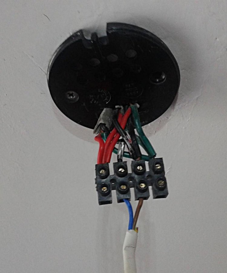

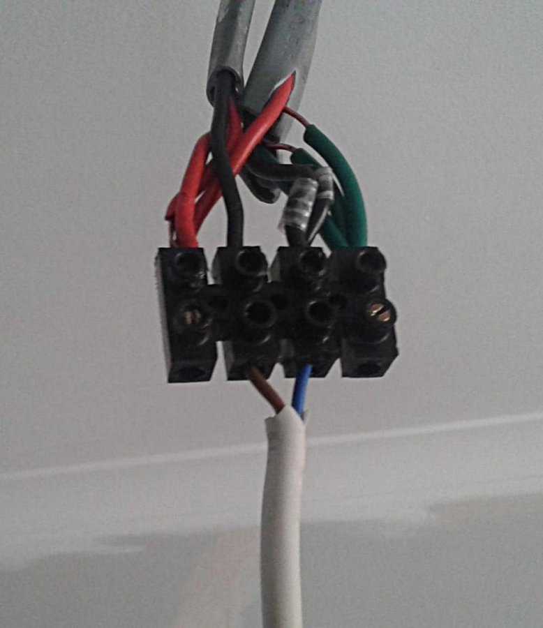

The light in room No. 1 is fine but not in No. 2 which will not light together with other lights in the house. Checked and rechecked the wiring several times. :(

Rooms 1 and 2
The only "neutral" that should be live is the switched live, and only when the switch is on which is a pretty simple way to identify it. It ought to be sleeved in red but often isn't.
The two "real" neutrals should be connected together, and to the lamp, so it is hard to see how one would be live and one not. A picture would help.
Both connections are identical but No. 2 does not work together with other lights in the house.
