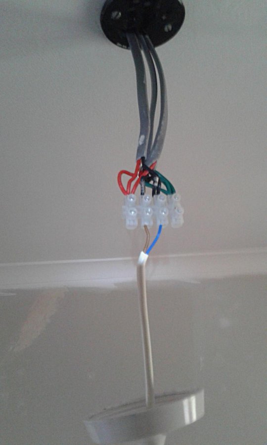

Switch wire. 2 of 3 are live!
This is with the circuit on at the fuse box, is it?
What do you measure between each terminal and earth?
Yes, all fuses for ceiling lights at the box are on: there are three, one General 15 amp and two at 5 amp. No, I haven't measured between live, switched live and neutral to earth. My measurements so far are live to neutral for voltage (35V) and live to switched live for continuity. Will I get readings measuring from live to earth, switched live to earth and neutral to earth? I apologize for asking step by step instructions.

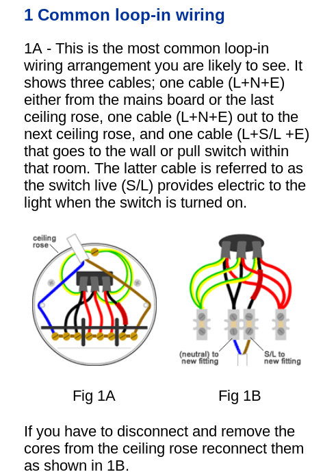

Your wiring is standard UK loop in wiring.
Take the rest of the afternoon understanding how loop in lighting circuits work.
Just measured live to earth: 246V.

Exactly my wiring.

I'd be looking at light no.1 and make sure that the blacks are right.
It sounds like you have got the out going neutral connected to the switched live.

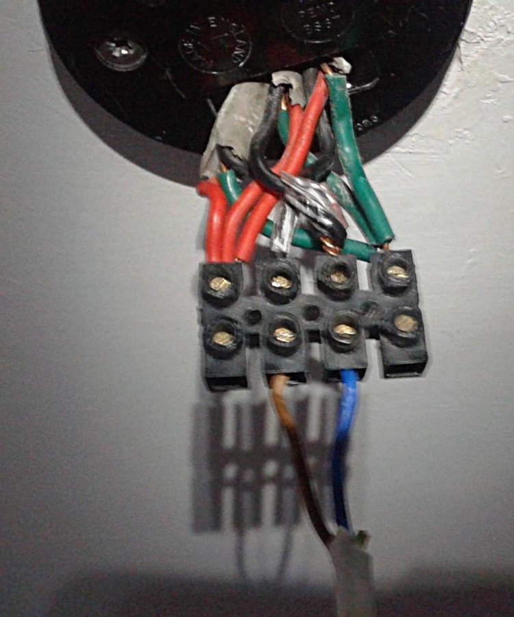

Thanks for coming in. R1 has been checked and rechecked (the flex were also duly corrected) and all wires are properly connected to the block. R2 is still not working, see new photo.
So at R1 you have definitely made sure which black is the switch wire.?
With the power off checked which black has continuity when the switch in that room is on, and then open circuit with the switch off?
Edit: That is testing between the 3 reds and individual blacks.
Checked once again following your instructions step by step (and rechecked!) and the wiring is correct.
