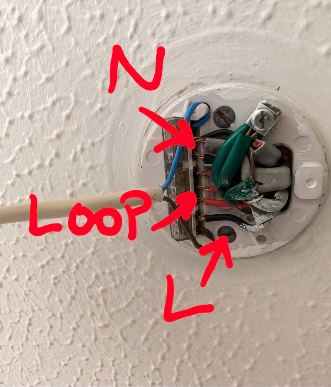

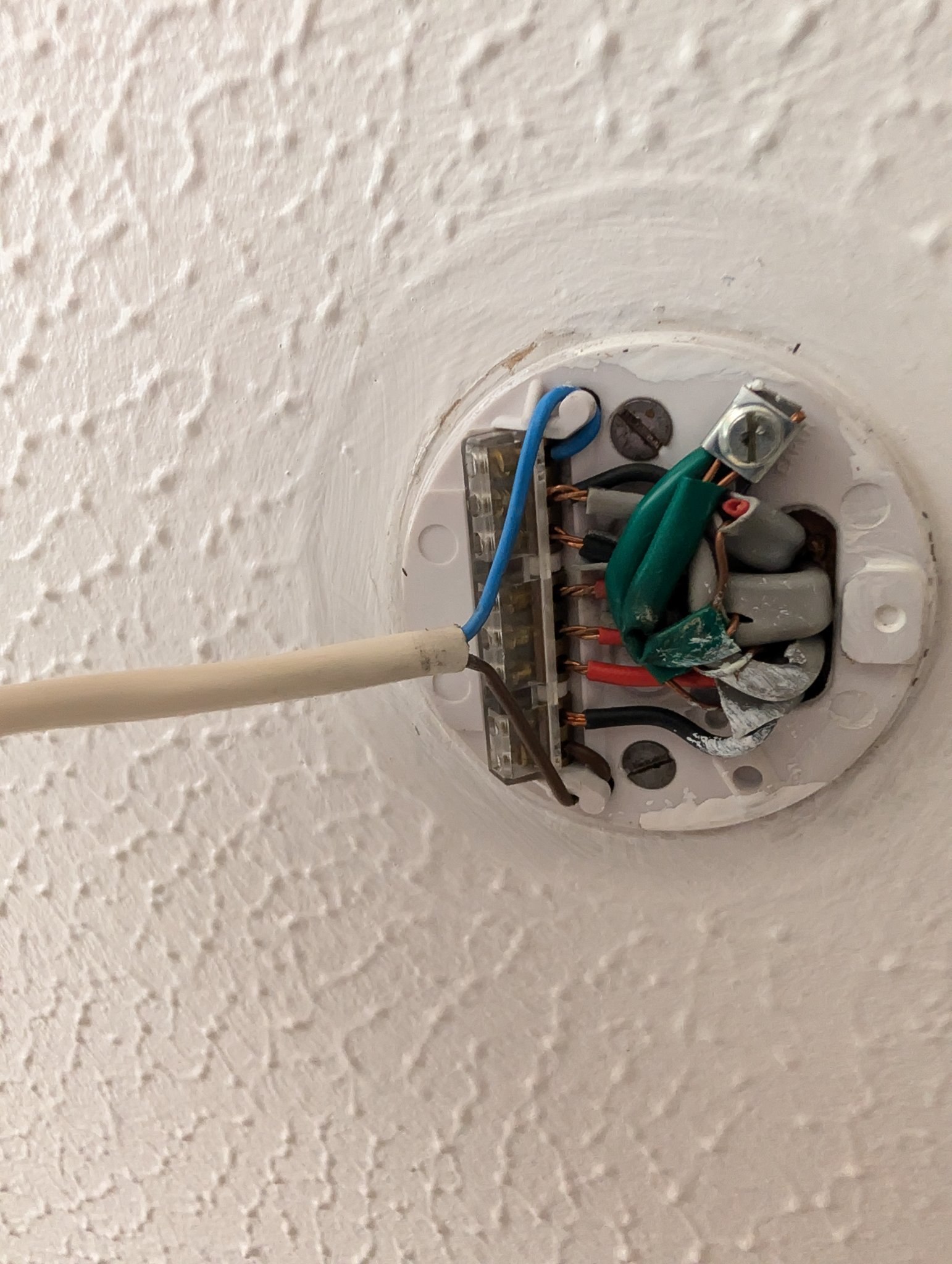

Hey folks, about to undertake the first of many of these around the house over time.
New light is double insulated.
So would I be right in saying.
Furthest left 2 black wires, go into 3 way wago, with the new light neutral going into the 3rd slot.
Middle 2 red wires, terminated in a 2 way wago.
Furthest red wire (switched I assume) in a 3 way wago with the new light live wire connected to the 3rd slot.
Earth (add sleeving) then terminated in single or 2 way wago.
That sounds right? Appreciate any help in advance!
Thank you!

you may not find all the ceiling rose look like that - as often you have the switched cable - a twin cable - would goto the middle set of three and then to the switch and then backup from the switch - so often you have a black which is live or switched live - BUT it looks like you have 2 T&E so live/Neutral in and then out to another light fixture - BUT a single core from the switch - so would be interesting to see the switch - maybe another connector block in the ceiling
Are you using a maintenace free box/enclosure that will go into the ceiling void or how will the light fitting have the wago in ?

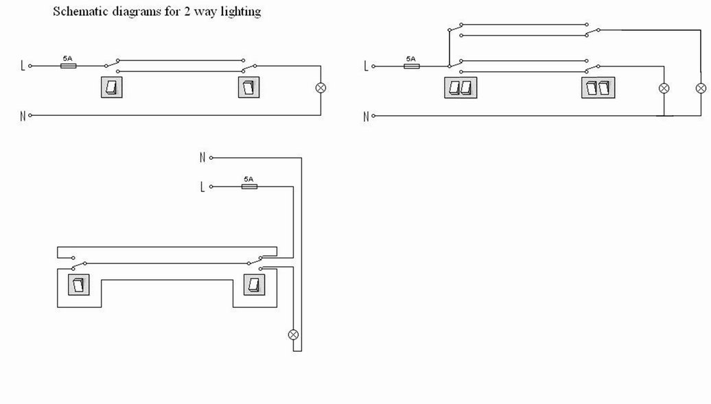

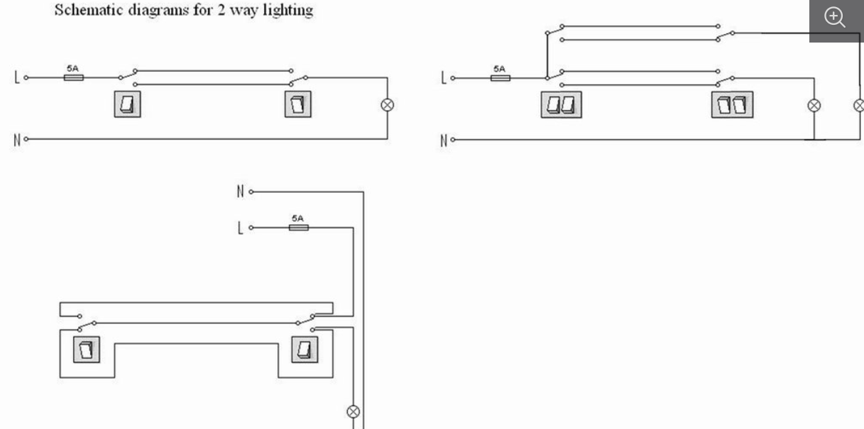

see here
And OLD colours
see here
And OLD colours
Ah, if it helps that particular light has two switches one from either side of the room - that could explain it?
I'll probably keep the wagos dangling and hidden by the new fixtures "surround"

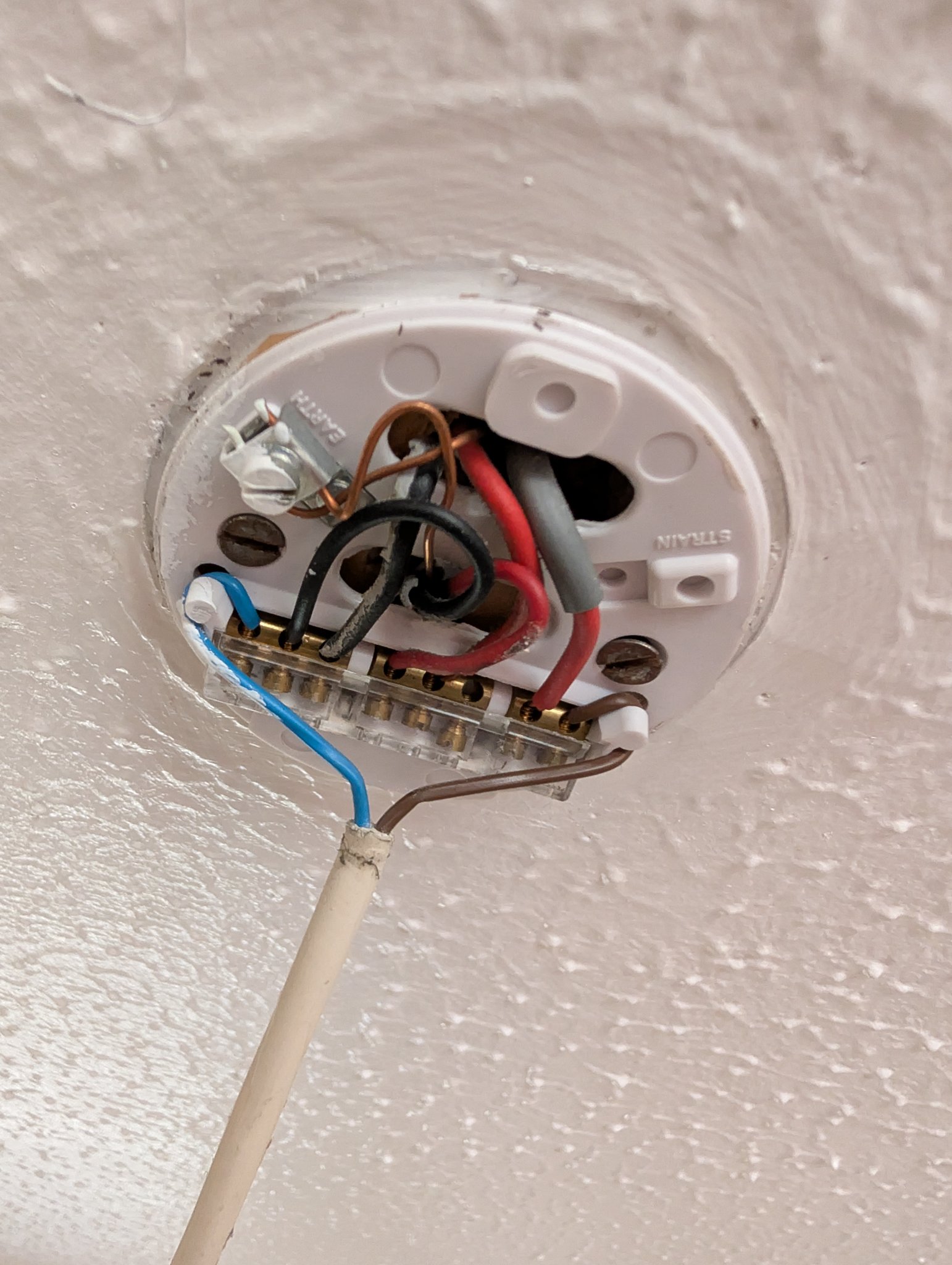

In the same room, the other light rose indeed looks different
For the light you want to do first your instructions are correct.
Take it light by light come back and ask for help if needed.
Always take before pictures
Mark with a marker pen or tape where needed
Always turn the power off, obviously
Before you do anything else, and before you disconnect anything, get a sharpie/some tippex and put a different number of lines/dots on each wire (so you have a red wire with no lines, a red wire with one line, a red wire with two lines…)
Then take a picture; a picture of 3 red wires all connected up before you started is no good if you can’t tell them apart after you disconnect them. Sometimes you get lucky with shape, stains, stray old paint etc but help yourself out; make wires obviously unique then take a picture
Next; your wagos are the exact replacement of the little brass bars. If 3 wires go into the same brass bar trapped by screws then those 3 wires shall go into a 3 way wago instead. If you’re running more light fittings off the same rose you can replace that brass bar with a wago with more ways, one extra way per extra light fitting
Your new light fitting goes where the old brown and blue connect up. If the new fitting is large enough to go over the old rose, just do that. If the new fitting hangs off a U shaped bar it can work well to remove old screw from the old rose, trap that bar behind the rose and screw it back up
If your new fitting is double insulated, simply don’t connect the earth up
