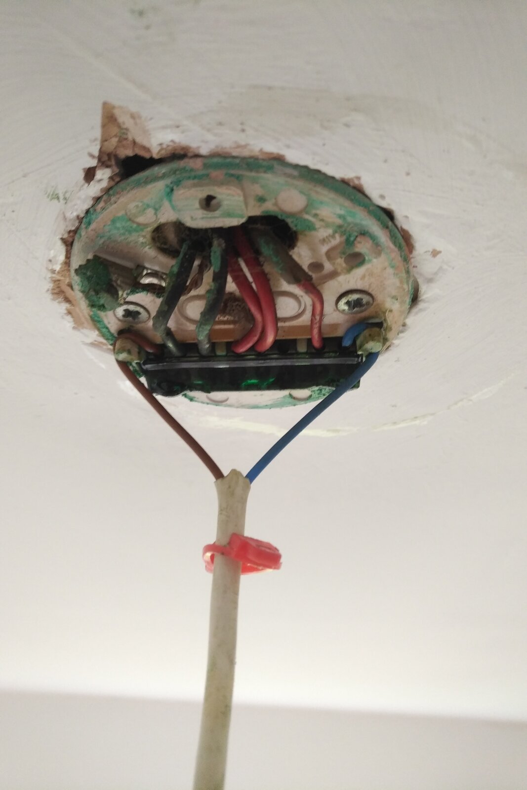

Hi all,
I have been changing a few light fittings recently, switching off the lighting circuit and checking each fitting is not live with a non-contact voltage tester and electrician's screw driver.
Two fittings down, and all going well.

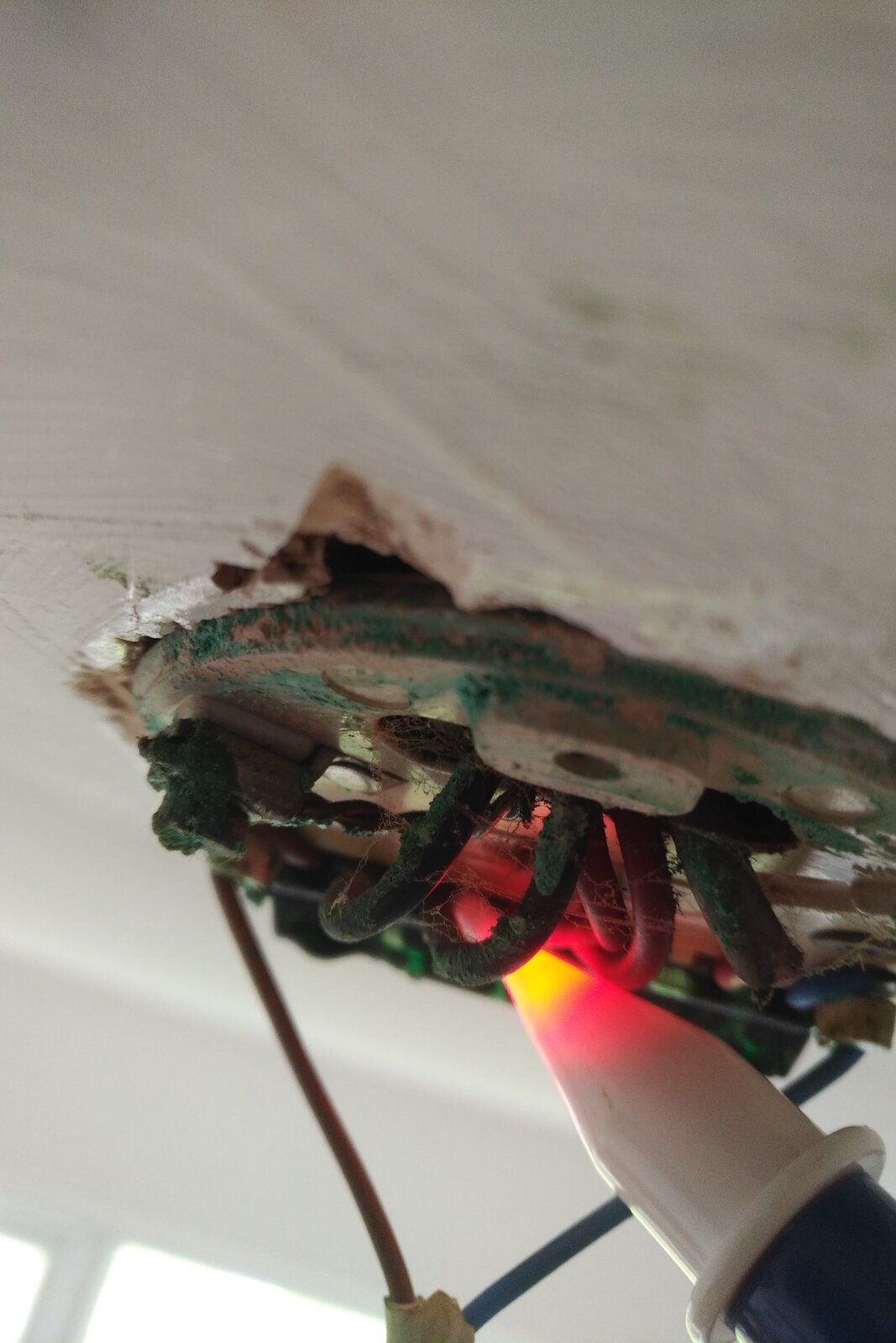

Then on the third fitting after switching off the lighting circuit (and checking the light no longer switches on), my non-contact voltage tester still detects a voltage if I poke it in the right place...
Is this normal?! Are there any explanations that don't involve there being a problem somewhere?
A quick google might suggest a borrowed neutral? But then why would not all fittings show this?
Any insight would be great!
Safe to say I am not proceeding until I get things figured out :)

This light is in the dining room. There is one main lighting circuit for upstairs and downstairs, and a separate circuit for the under-stairs light (which is next to the dining room, and contains the consumer unit, or whatever it's called these days).
Turn off both lighting circuits and see if that makes a difference. Test with a multimeter.
Add G&Y sleeving to the earth wires at each point you open, and clean off the green slime, especially in switches which need replacing if contaminated.
Showing 5 or 6 volts with either just the main lighting circuit off, or the main and under-stairs lighting circuit off.

When I replaced two other fittings, I just carefully replicated the original wiring, which looked reasonable to me.
I also don't understand why there are three live and only two neutral wires at this suspect fitting.

Voltsticks do give false and misleading readings.
You can sometimes get some very low voltage reading when a circuit is isolated by just turning off a fuse or mcb. However, if there is any doubt all is not well, you should completely isolate the whole house to be sure all is ok. Always work safely and if in doubt always send for an electrician.
As to whether you have a borrowed or shared neutral, further investigation is needed.

The pictures show the pendants connected reverse polarity, the brown should go to the single red not the 2x black conductors
Thanks. I noticed that, too, and switched it round. Obviously wouldn't account for strange behavior, though.
