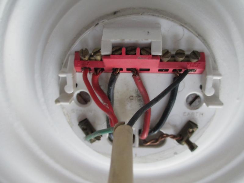

Hello,
Trying to replace an old ceiling rose -slightly confused by the existing wiring.
I seem to have (left to right)
1 Live to lamp
2 Live from circuit
3 Neutral from circuit
4 Live from circuit
5 Empty
6 Empty
7 Neutral from circuit
8 Neutral to lamp
On the basis of other wiring diagrams I've seen, I was expecting that 2 would be Neutral/black (perhaps with a red sleeve) and 3 would be live/red.
The light has worked fine since I moved in 15 years ago.
Am I OK to just copy the existing wiring into my new ceiling rose ?
Any help very gratefully received.

Some numpty has mixed up the switch wires
Turn the power off
Swop over the red and black wires at the left so you now have two reds in the middle and a black on the left (ie the live to the lamp).
Put a red sleeve over that black to show its a switched live.
PS You shouldn't see any bare copper into those terminals, and the earth conductors should have earth sleeving (green/Yellow)
It may be that the red and black coming out of the ceiling are the wrong way round.
No real reason why the switch live can't be red, and the permanent live can't be black (but sleeved red).
Best thing to do is to confirm which of the two CABLES emerging from the ceiling is the switch CABLE.
Then put the switch cable black in with the live pendant flex,
The remaining black (neutral) in with the neutral pendant flex,
Both reds together in the centre loop terminal,
The earths together in the earth terminal.
Agree with what is said above.
When you follow those instructions your switch may turn the light off when it should turn on or vice versa.
So if the above is done make sure the red goes in the C at the switch and the black (with red sleeving) goes in the L1.

I don't agree with that, unless the switch itself is interferred with, the switch will still work the same way up.
A 2 way switch can be wired to work upside down, a 1 way can't, unless physically turned upside down.
Which cable is the switch wire?
The one connected to the red of the light fitting.
Also, the cpc (earth) of the light fitting should be connected to the other cpcs.
Unless the two earth terminals in the rose are connected, which is unlikely.

Well, if it isn't then the two reds together are neutrals and the blacks are all lives.
Nothing's impossible, I suppose.

OP here.
Thanks very much to all for posting. In the end, I tried replicating the original wiring in the new ceiling rose. (So each wire kept its old position in the new rose, with new lamp brown replacing old lamp red in position 1, and new lamp blue replacing old lamp black in position 8)
Seems to work perfectly. I'm thinking if it hasn't burned down our house in 15 years, it should be OK now. Or am I being complacent ?
Only difference is that the new rose/lamp has no earth wire, so I taped up the bare copper earth wire from the ceiling and left it unconnected.
