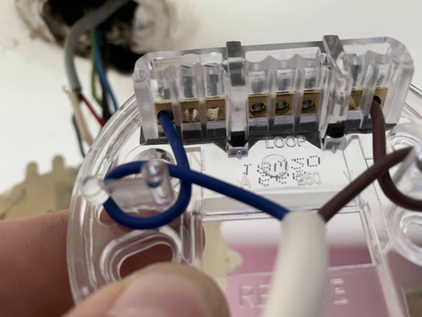

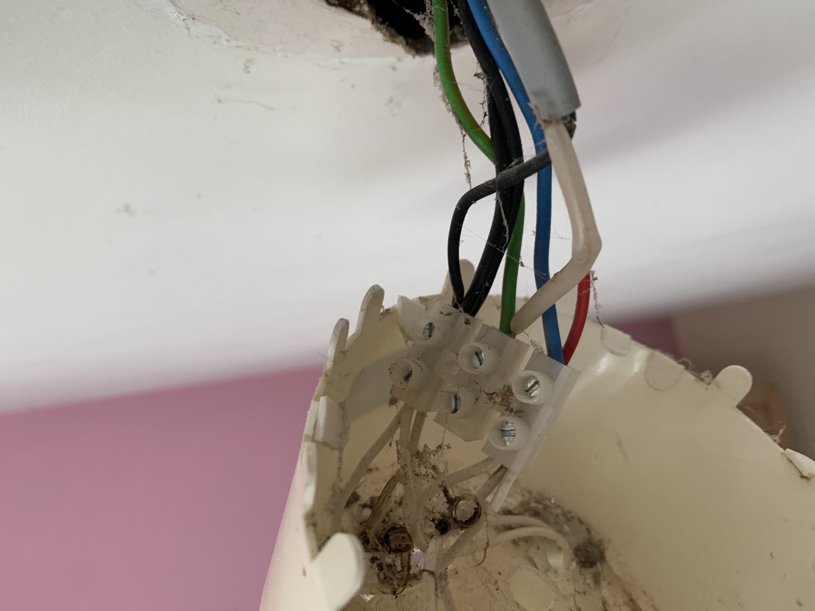

    Can anyone tell me how to wire up this ceiling rose?
    Current
    New

    It is rather unusually wired, but IF everything has been working as it should, then -
    Red and Blue to new Brown,
    The three Blacks to new Blue and
    The Eartn wires to new rose Earth terminal

    Worked like a dream - many thanks again!
