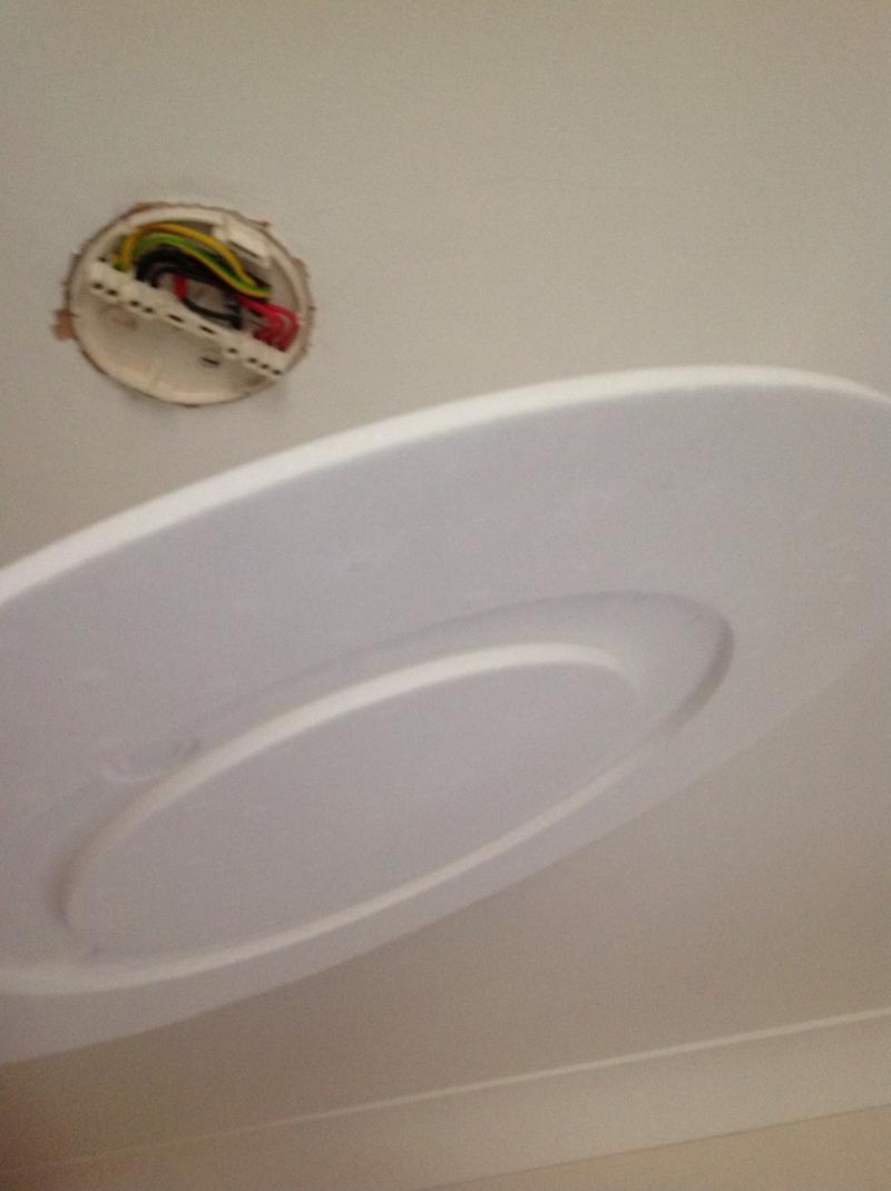

I have bought a budget ceiling rose (polystyrene), hopefully the picture explains my problem (picture shows the back of the rose, the front is more decorative of course).
The back of the ceiling rose is flat, but I have all the wires from the light fitting proud of the ceiling.
I know this isn't the correct answer but it's like I need to remove some of the back of the ceiling rose so the wires sit inside it and the rose can sit flush on the ceiling.
Any help appreciated.
If you intention is to have the feature sitting flat to the ceiling you have options, which may depend on the light fitting you are going to connect.
You could simple remove the existing rose plate and pull conductors through the feature, you could cut out the circular shape of the ceiling rose out of the feature rose or you could fit a dry-line circular recessed box.
http://www.tlc-direct.co.uk/Products/MTMDLB6.html
I guess I could cut a circle out of the new ceiling rose (exactly the same size as the existing plastic ceiling fitting), therefore the extg fitting will then sit within the rose. The ceiling rose is about 20mm deep.

i would remove the rose from the ceiling, cut a smallish hole in the polystyrene to fit the wires thru, and then attach the rose to the underside of the polystyrene, with long screws thru into the original fixings.

You need to isolate the power completely and remove the electrical ceiling rose, fit the polystyrene ceiling rose, and refit the ceiling rose.
Make sure you connect the wiring AS IT IS, not as you think it should be!

Well the simple answer would be to remove the lighting rose and pull cables through a wee hole in the ceiling rose feature, then reconnect or install a new ceiling (light) rose.
Just make a note of the connections, I have spotted the switch live is sleeved red. it is in your best interests that that red sleeve remains on that conductor.

There could be enough slack on the existing cables to pull them through, but it looks like you would have three sets of cables (9 conductors/wires) coming through your feature and that would be quite normal for a standard loop-in lighting arrangement.
The problem being some light fittings are manufactured in such away that they make it very difficult to allow for the space of the three cables and the ease of terminating them.
A solution would be to install a maintenance free (MF) junction box in the ceiling void, theses are designed so that no maintenance is required on the terminals once connected and can be left in the void, and hopefully you would never have to access them and the feature can be glued.
All you would need to do is, disconnect the lighting ceiling rose, note down the connections, make a void for the MF junction box to go in, connect the cables and the connect a forth cable that will act as the supply to the light.

Couldn't I just take the existing ceiling rose, cut a whole in the ceiling, push the ceiling rose in the hole. The new ceiling rose (polystyrene one) will cover the hole.
If I was to install a maintenance free (MF) junction box in the ceiling void (as suggested earlier in this post) and glue the ceiling rose (polystyrene one) over it, the terminals won't be accessible.
