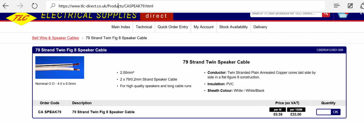

Right then, all you need is what I said in my first reply: a 42 strand or 79 strand all-copper speaker cable with a cross-sectional area of 2.5 square millimetres or more. Ideally for in-wall use the jacket should be Low Smoke Zero Halogen (LSZH) rated but I wouldn't lose too much sleep over that. If the cable is listed as 'Oxygen Free' then that won't hurt, but don't go paying a big premium for that as ordinary 100% copper speaker cable is already pretty pure. The only thing I would insist on is a clearly visible polarity marking. Basically you want to be able to see easily which which of the two conductors you have connected red or black.
That's all. What you buy and from where makes little or no difference so long as you adhere to the basic specs laid out above. :)
Thanks @Lucid. I've been scoring the net today. I will need around 100m. Does this seem suitable?
Thanks, you've been incredibly helpful.
