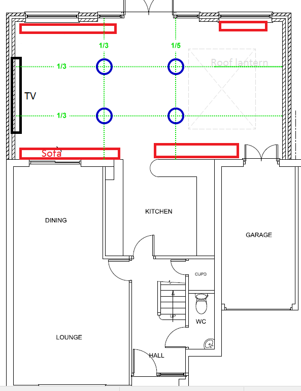

On the placement of speakers I've now read your guidance twice but I'm stil struggling with the locations you are suggesting. The preamble makes sense and I found the theory very interesting. I thought it would help if I send you a map of my house along with an indication on where "stuff" is and is going:
The red rectangles are sofas and there will be a dining table below the roof lantern. The roof lantern is around 3m by 3m.
For completeness, the amp, etc. is going under the TV and I want speakers throughout the ground floor. This includes the front lounge and dinning area along with kitchen and hallway. I'm also going to be stuffing acoustic insulation between the floor joists.
I thought If I can understand the rationale used for the lounge at the back, I can then extrapolate this out for the rest of the house. Thanks again.

Hi @Lucid, I'm struggling with the placement and this part of your post:
Even fractions are bad acoustically. Don't put your speakers in at 1/2 or 1/4 or 1/8th position of the length or width. All it will do is excite the room resonant modes and make certain frequencies boomy. Equally, don't arrange your seating so that listeners will end up sat with their heads at 1/2, 1/4, 1/8th etc of the length or width. What you should do instead is aim for speakers and listeners to be at the odd fractional lengths instead. So a 4.7m width means placing the centre of the speakers at 4.7/3 (1.56m) from the front or back walls. A 9m length means 3m from the side walls.
Where is the 1.56m point for instance? How many speakers are reccommended in this space? How much distance do I need to have between each speaker? That's the part I am unclear on.
There was also a focus on the configuration of the room so I thought it would be helpfulto draw this up for your comment.
Instinctively, I felt that I would need 4 speakers in this space but I would struggle to substantiate this...

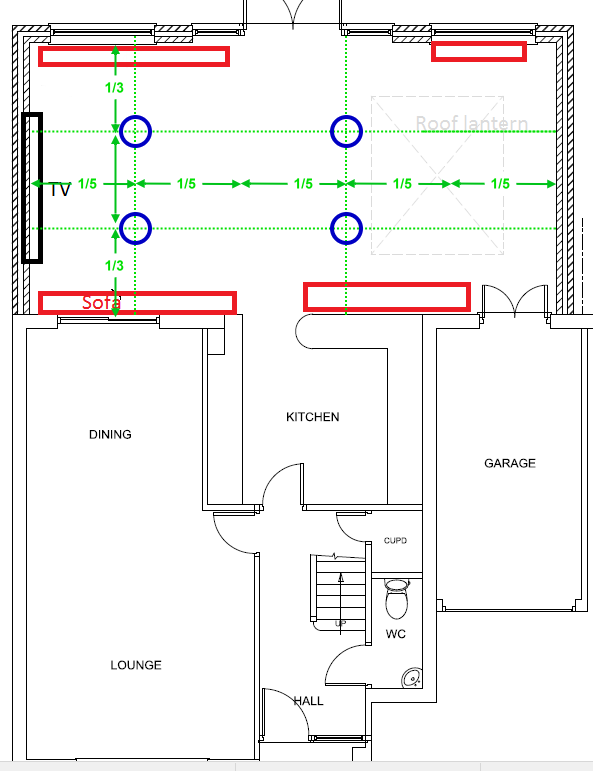

Okay. I presume you understand the concept of fractions well enough that if I said divide the length of your room in to 1/3rds and mark each division then you'd take 9m, divide it by 3 and end up with 1/3rd = 3m, right? Then taking the TV wall as the start point, you put a mark at 3m to signify the point that is 1/3rd of the room's length, and one at 6m to signify the point at 2/3rds of the rooms length.
Now if I said "Please divide the room's width in to thirds" then you'd follow the same method, correct? So 4.7m/3 = 1.56m = 1/3rd. Therefore 2/3rds = 2x 1.56m = 3.12m
Then if I said "Find the point on the ceiling of your room that is 1/3rd the length back from the TV wall, and 1/3rd the width of the room from the wall with the bi-fold doors", would you be able to do that? That's all this is. It's dividing the room up along its length and then its width, and then seeing where those lines of division intersect.

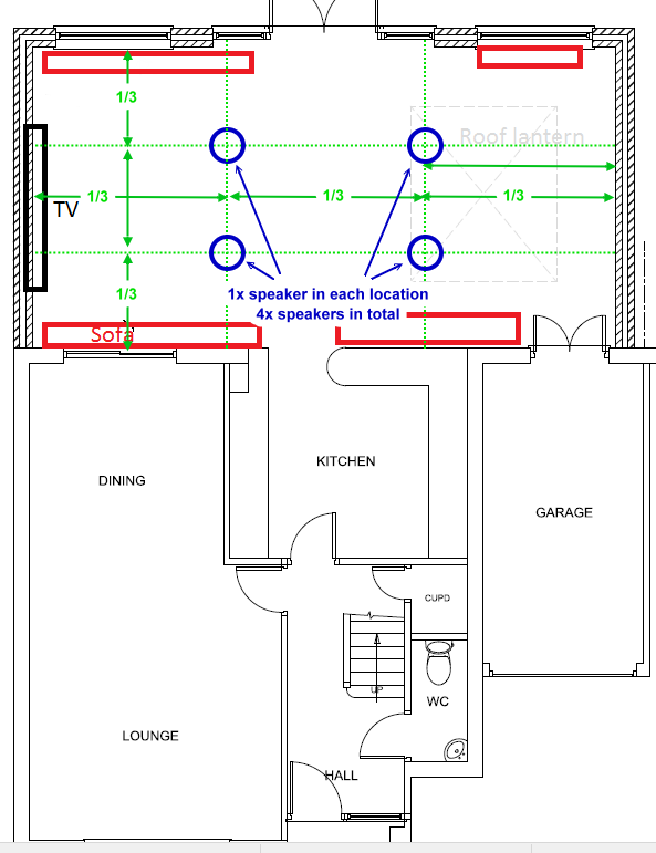

Clearly the right-most speakers can't go at a 1/3rd multiple of the room's length because the roof lantern is there. So the next thing to do is divide the room's length in to 1/5ths and see if the result is any better. (see below)
Of course there's nothing to stop you mixing 1/3rd positions and 1/5th positions. The diagram below shows the speakers nearest the TV at 1/3rd of the room length and those nearest the roof lantern at a multiple of 1/5th.
The point of the exercise is to take some control of the speaker placement based on solid acoustic principles rather than accepting some arbitrary positions because "It looks nice" or "That's where the electrician put them". Both those result in the"horrendously unsucessful audio installations" to which bernardgreen alluded. Electricians tend to go with what's easiest and most convenient for them; by-and-large they are not audio and video installation engineers.

@Lucid I really appreciate the effort you have gone to. Thiss is very helpful and I am now very clear on what needs to be done. One further question if I may please, what detrmines whether I should have 4 or 10 speakers in this space? Is this an arbitrary decision or is there some sizing that goes into this?
If I did want two speakers in this area, presumably I would then divide the width into two to find teh central point and then carve the length into 1/3 or 1/5 and put the speakers at the intersections? I ask this question, both to understand the prinicple above but I may have this situation in the kitchen, hallway, etc.

What type, how many, and the configuration of speakers is driven by the volume of space, and the background noise to be dealt with (homes are generally fairly quiet compared to say factories or shops, so this is less of an issue), and whether the client wants sound focussed over a certain area (seating zone) or spread out evenly throughout the space. Then there's budget of course.
Unless the budget is unlimited then hallways and utility areas generally don't generally require the sort of quality that you'd have in the main listening areas. For this reason I tend to use smaller 'contractor quality' speakers or the base-models of the better ranges. These are speakers with a 4"~5" woofer and a basic Mylar (plastic) tweeter. They generally tip in at around £50-£80 each. These don't have a lot of bass but they're only used for background sound levels.
For small areas that justify better quality then a single-point stereo speaker is ideal. This looks like a single 6"-8" speaker but it works a bit like a sub-sat speaker system that you might use with a PC; there's a single bass driver which is mono, but two tweeters, one for the left and one for right treble frequencies. It is fed by two speaker wires (Left and Right) just like you would wire stereo speakers. The speaker itself has two sets of connection (left & right) and a circuit called a crossover does the bass / treble and left / right split. The result is that stereo sound comes out of a single point in the ceiling. Single-point stereo speakers are good for bathrooms, dressing rooms, en-suites, small kitchens etc. I tend to use them in spaces up to 3x3m. Good quality ones generally start at around the £150-£200 price mark. These have enough bass and high-enough audio fidelity to be comparable with- or superior to- a typical £200+ mini or micro Hi-Fi.
For larger areas such as your lounge-cum-dining area then small contract speakers and single-point stereo speakers aren't suitable. Here's where you need more bass (so a bigger bass driver at 6"~8") and a Hi-Fi grade tweeter (soft dome or titanium metal). Other useful features are a tilting tweeter so that the sound can be directed somewhat; maybe some bass and treble adjustment;and possibly the ability to link speakers in a daisy-chain so that 4 speakers only take up the same number of outputs as a basic stereo pair. This last feature is called "4/8 Ohm Switching" and it doesn't appear on too many speakers but it saves a fortune in amplification costs. The bass is equivalent to a typical £300~£500 mini or micro Hi-Fi. These ceiling speakers start at around £250~£300 per pair.
If you are concentrating the sound around (over) a central listening area then four speakers should be sufficient. On the other hand, if you want sound everywhere and for it to be at an even volume throughout a large room then you will meed more speakers. As a rough guide then speakers of this quality will be required at a coverage rate of approximately 1 per 4~6 square meters. This would equate to 8~10 speakers in your room. However, you have a ceiling lantern so some of the ceiling area is missing, and it's also going to have an effect on the sound beneath it, so I would avoid putting speakers too close to it. Unless there's a compelling reason to do otherwise, then the most I would go is six speakers in that room at the 1st, 2nd and 3rd 1/5th points back from the screen.
Right so you have 4 speakers in that room. Which ones go to the left channel and which to the right?
